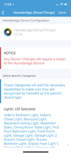

I’ve ported over and heavily modified the Homebridge (HomeKit) plugin/smartapp made by @pdlovelace.
Screen Shots
New Features
Added Alarm support for Hubitat Safety Monitor
Added inputs to define device types in HomeKit for the following:
- Lights
- Fans
- Speakers (Not Supported in Home App) - Apple has really didn’t add much to this except mute and volume control
- Window Shades (Currently works with the Generic Z-wave Drive)
- Native HomeKit Irrigation Support (Rachio Only at the moment)
You can have Devices created for selected modes in HomeKit that will trigger modes. (They are On when the linked mode is active)
Added the ability to restrict HomeKit from creating temp devices for Contacts and Water Sensors
I’ve added support for pretty much every characteristic HomeKit supports that aligns with SmartThings capabilities
