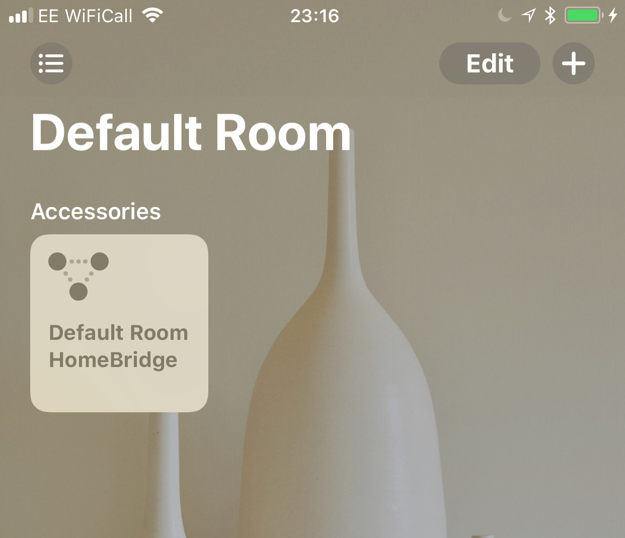

Is it normal to have 2 tiles per thermostat, one of which is greyed?
I also have a greyed homebridge tile.
Ideas?
F2BCBB79-F4CD-472F-B9DD-3C693663BB031EA82BB7-45E8-4393-A398-47D03BB3D817
The Homebridge Tile is your controller, that’s normal. As is the other, as you’re seeing one sensor and one “thermostat control”. You can group them together into one device in HomeKit if you hard press on one and go to Details.
