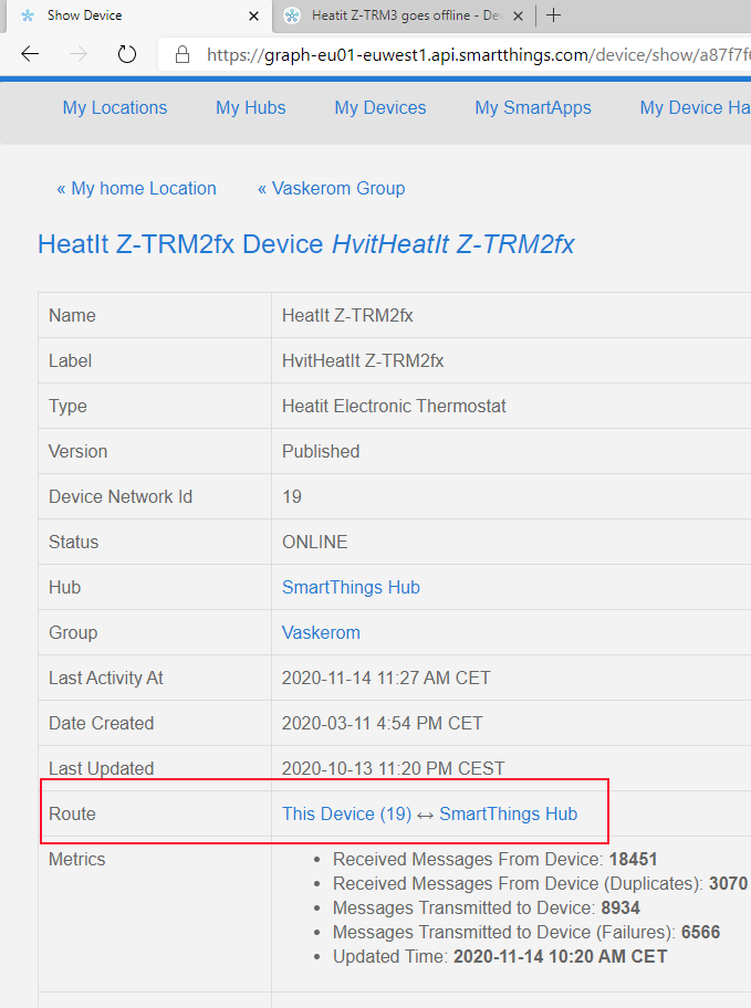

Regarding point 2; This Z-TRM2 is the closesest device to the hub. It is only 2 meters from the hub. All other devices are further away. But, when looking into the device on the ST web-overview, it is actually routing through one of the Z-TRM2fx, which is further away (maybe 5-6 meters from the hub). So this is quite strange…

That may be the issue actually, try this. Exclude and power down your TRM2fx and see if the problem goes away. The TRm2fx stops routing messages when overloaded and that may explain why your TRM3 goes offline.

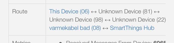

So, I did a reset of the Heat, with the Smartthings Hub right next to it (By pressing buttons Right and Center (down and confirm) for 20 seconds). And I made sure everything else is powered off. Then it automatically got connected and the routing is directly to the Hub.

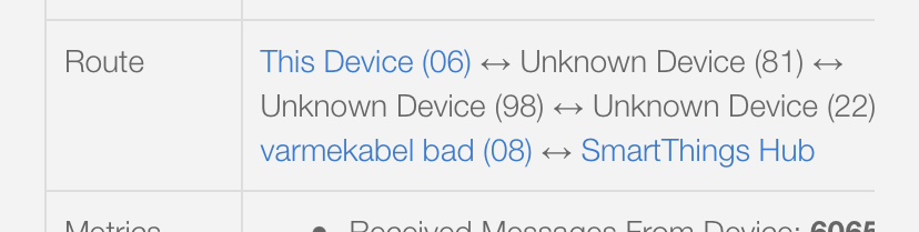

I think the number you see in parenthesis “Unknown Device (98)” is the Network ID. So if you look in the table of My Devices, you can find out what they are. (and turn them off, while re-setting your Heat)
So my problem seems to be ghost devices in the route. I have tried several times deleting these devices by following the process of adding them by id and then force delete them in the app. Then I have tried to repair z-wave, but get “failed to update route” — and new unknown devices (new id’s) appear in the route to my TRM3.
