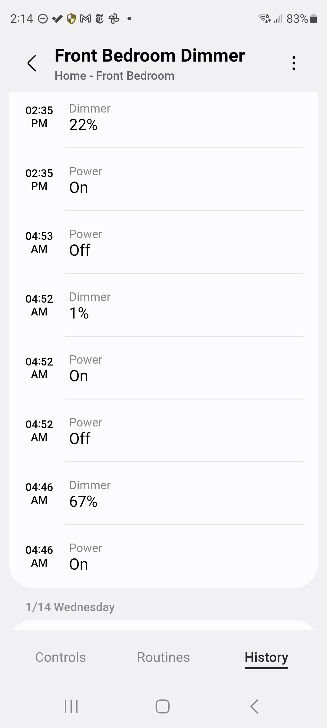

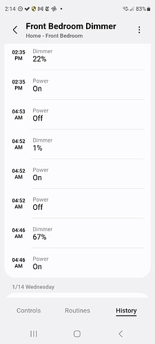

At 4:46am, an older GE by Jasco Zwave smart switch that powers ceiling can lights turned on. It did so on its own. I’ve seen this behavior with this specific switch on occasion before. It didn’t even acknowledge the previous dimmer setting of 22%, but came on at 67%. (At 452am onwards, all was done by direct control on our end.)
There are NO routines whatsoever attached to this device.
Before I just rip it out of the wall and replace it, anyone have ideas on why this happened? Or possible cures to it? (short of dumb routines that check if it’s coming on in the AM wee hours and turning it back off…)
