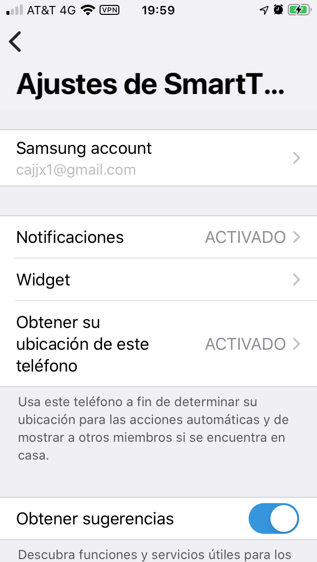

Hi my friend, I am wondering what is happening about you cannot set an automation, but take a look for this screen, I think its close what do you want, I just did it, I hope this can be useful…
This is exactly what I want to do but I want to use my second household member so it would look like:
If
Carlos’ iPhone arrives
Or
If Christy’s iPhone arrives
Then
Disarm
as well as
If
Carlos’ iPhone departs
And
IChristy’s iPhone departs
Then
Arm (away)
The work around right now is using a scene widget and setting it manually. I think there is a way using life360 but I can’t seem to install the smart app.
Thanks for your input! Much appreciated!
You have to install New App in 2nd phone, enter to gear icon and activate the phone as a presence location device (Option “Get location from this Phone”, in the screen shot "Obtener su ubicación de este teléfono)), I read some time ago to be sure it works fine its preferred you add a different mail (samsung user) to the members list of your location (one different mail per member and login with different member on each mobile phone) because use same mail (samsung user) in different mobiles could give errors.
