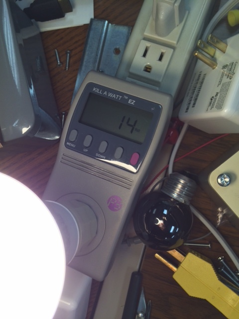

This discussion is all very subjective. How much heat sinking, how the heat is being dissipated. If you have one of those devices that measure power usage (they’re accurate to the .01 amp), just measure how much current it’s drawing compared to the 11 W TCP bulb. If they both draw the same amount, then they’re both producing pretty much the same amount of “heat”, as long as the light output is similar.
@wolfram, I used a Kill-A-Watt meter to measure the 11 Watt TCP bulb and the meter says the TCP bulb is drawing .13 Amps at 129.6 V @59.9 Hz with a Power Factor of .82. In total, 14 Watts consumed by the TCP bulb.
A typical 60 Watt incandescent bulb will consume, surprise, around 60 Watts of power of which the majority is lost as heat.
The TCP bulb does not consume anywhere near 60 Watts of power, the difference being 46 Watts!
The 11 Watt TCP bulb will not produce as much heat as a 60 Watt incandescent bulb because LEDs are more efficient at producing light in comparison to a tungsten filament. In other words, for the same amount of light produced by the incandescent bulb, the TCP bulb doesn’t need as much power. Yes, the heat sink on the TCP bulb will get hot, but not nearly as hot as that 60 Watt bulb. I can still touch the surface of the TCP bulb heatsink without burning myself, but only briefly. I refuse to touch the surface of a 60 Watt bulb for any amount of time.
