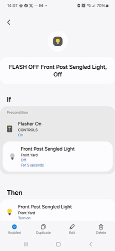

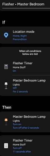

I migrated the SmartThings Flasher Smartapp to Routine(s) (Automations) a while ago. Like most things when migrating from an SmartThings Smartapps to Routines, I had to use two Routines.
Like @oliverrl, I’m using a Virtual Switch for the flashing.
First I create a Routine with whatever triggers that turns On the Virtual Switch which I’ve called Flasher Timer.
Then I created the Flashing Routine for the Light(s) I want to flash. This is what it looks like. I tried to use one second, but it didn’t work right, so that’s why I’m using two seconds. That being said, I just do the math calculation to turn Off the Virtual Switch after the amount of time it has ‘looped’ enough to flash the light(s) however many times I want. I can even have the lights(s) continue constantly flashing by not turning Off the Virtual Switch in the Routine so that I then have to turn it Off manually or by another Routine trigger. Also, this will flash the light(s) when the light is Off so reverse the light condition on both sides if you want it to flash if the light is On.

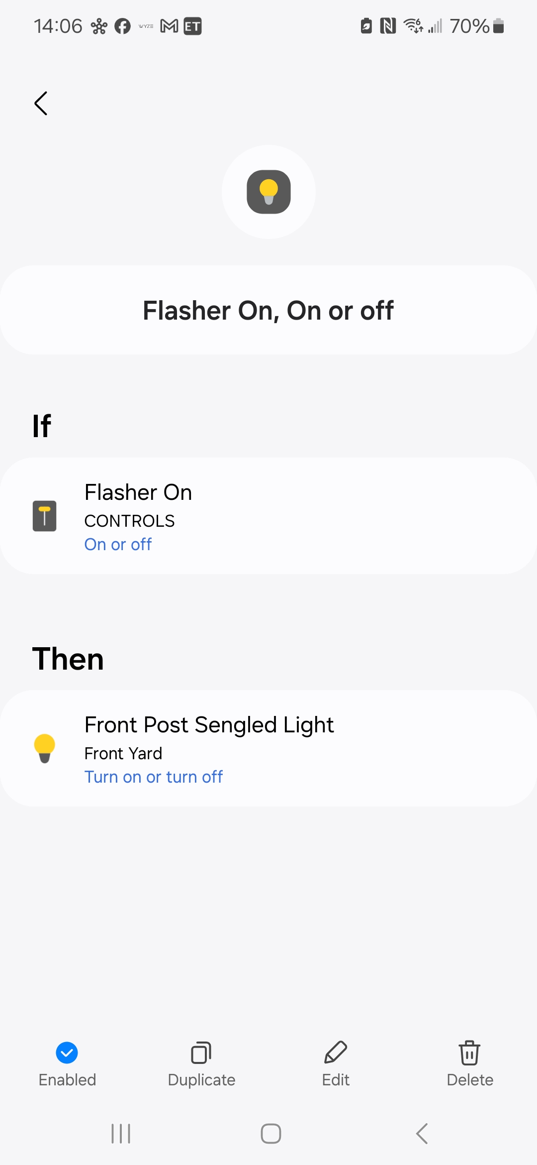

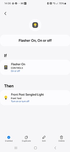

Yes, you are exactly correct. In order to start the routine, you do need to toggle the status of the light, otherwise you have already timed out the five seconds. I forgot to mention that, but you figured it out ok. I like the idea of setting the routine in Google as well!
I added a routine that says when I turn the Flasher on, also toggle the light (regardless of the state) which then clears the condition to reset the timers to zero and allow the flash to start. Then when I want it to stop, I just turn off the Flasher routine. Works with Google Home now, I can say “Turn on the Flasher” and when I want it to stop, say “Turn off the Flasher”. I think it can be good for emergencies, if you want Fire, Police or Ambulance to know which house to stop at, as well as telling the kids to come home. See screenshots from link below…
