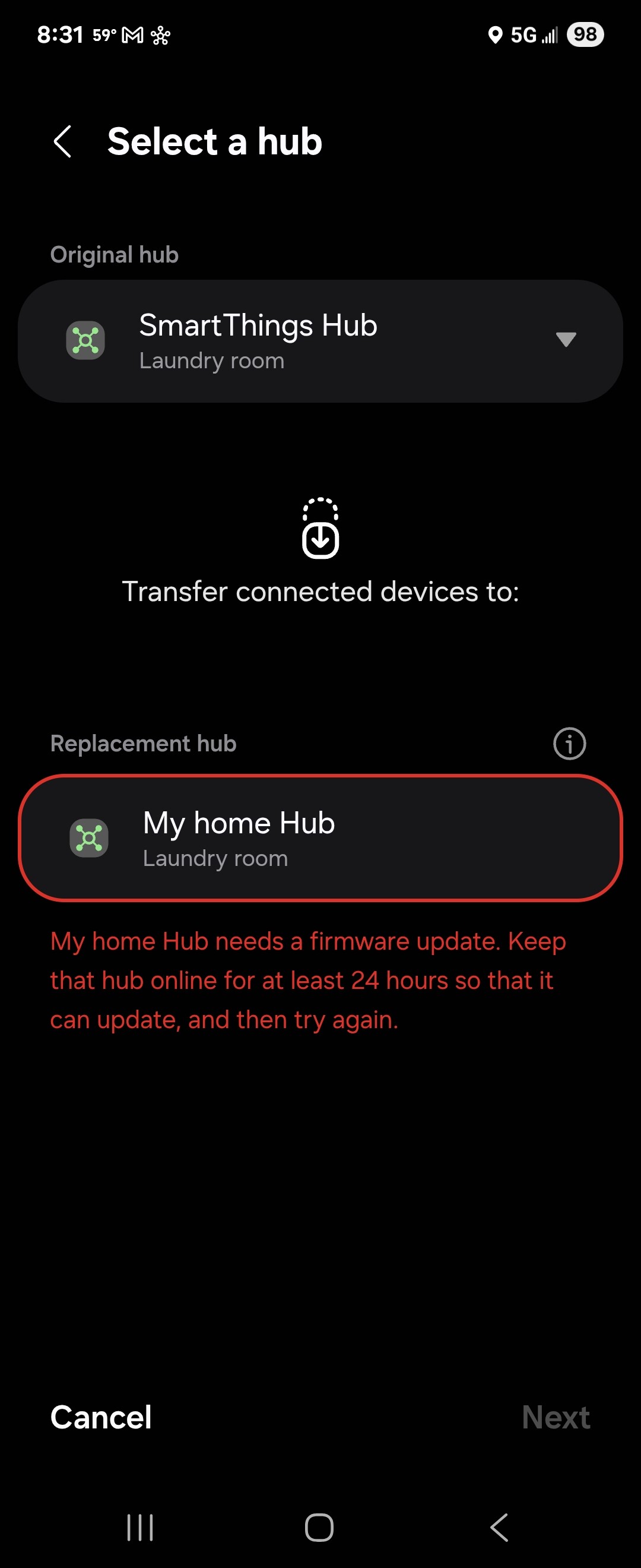

Hi, I just got my replacement (used) hub connected a few days ago. Thanks for help @nayelyz and @Itati.
However, after several days, I am still unable to complete the replace hub (transfer connected devices) process. I am getting the message that the hub “needs a firmware update.” The update doesn’t seem to be happening. I have it on automatic firmware update. I also tried switching to manual, but I don’t see how to trigger a manual update.

Thanks @jkp, I see a setting when I click on settings for the “new” hub, but maybe that setting doesn’t do anything. (Right now the hub is just an unconnected device until I can set it up as my replacement hub.)
Firmware v 000.036.00005
There is also an “app version”, whatever that is, which reads: 1.0.41-17

Our engineering team was able to complete the firmware update on your Hub.
It has now been updated to the latest available version.
Could you please confirm if everything is working properly on your end?
Once we receive your confirmation, we’ll proceed to close the case.
Thank you!
Thank you! The transfer seems to have worked - I have now successfully replaced my hub. Whew, that took a lot of troubleshooting.
