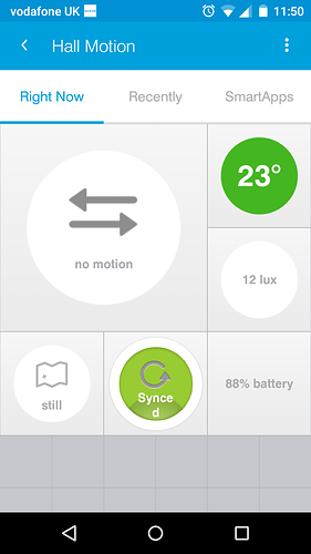

I’ve just installed this device. I’m confused since mine looks different. I don’t have the buttons for smart apps preferences and activity. Also I tried forcing a sync but still get no lux or temperature. Any ideas?
I took the battery out and in again and at least it is now showing a lux value and a temperature and a battery reading of 88%. The motion now seems to work
I still dont understand why mine doesn’t have the extra buttons in the screen shot above? Also the screenshots above have a little circle in the top right corner of each button but mine doesnt?

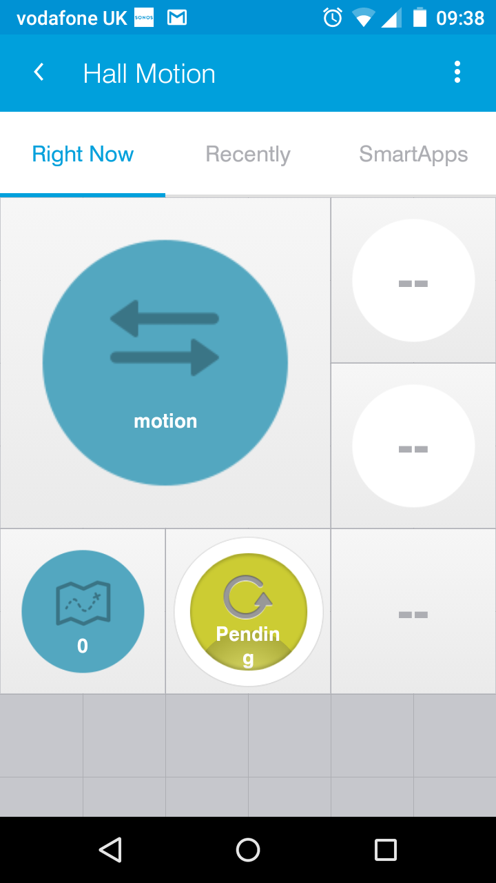

Only issue I’m having is the “pending status” never clears. Originally it was working fine, but now when I make a change to the device type it is stuck. Tried rebooting the smartthings hub to no avail.
I had the same problem as the other person but I did not totally follow what the fix was. Will I never have it if I have v2 ST iOS app? I hooked up the Fibaro sensor today and maybe I just need to give it more time, but I still don’t see a Configuration or Preferences button. Without those, I am not sure how I am able to modify the settings. I have the Github repository linked, so pretty sure I have the latest update from @CyrilPeponnet but I am pretty new to ST, so guessing I screwed something up.
