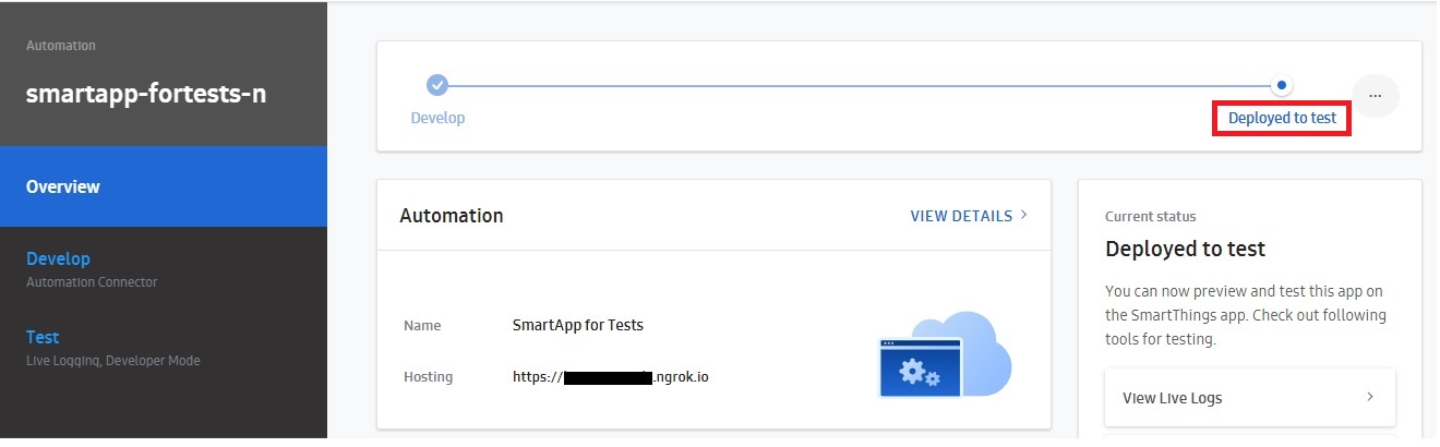

Make sure you deployed your SmartApp at the Developer Workspace, @JFry. It doesn’t appear in the list otherwise.
Eg.
