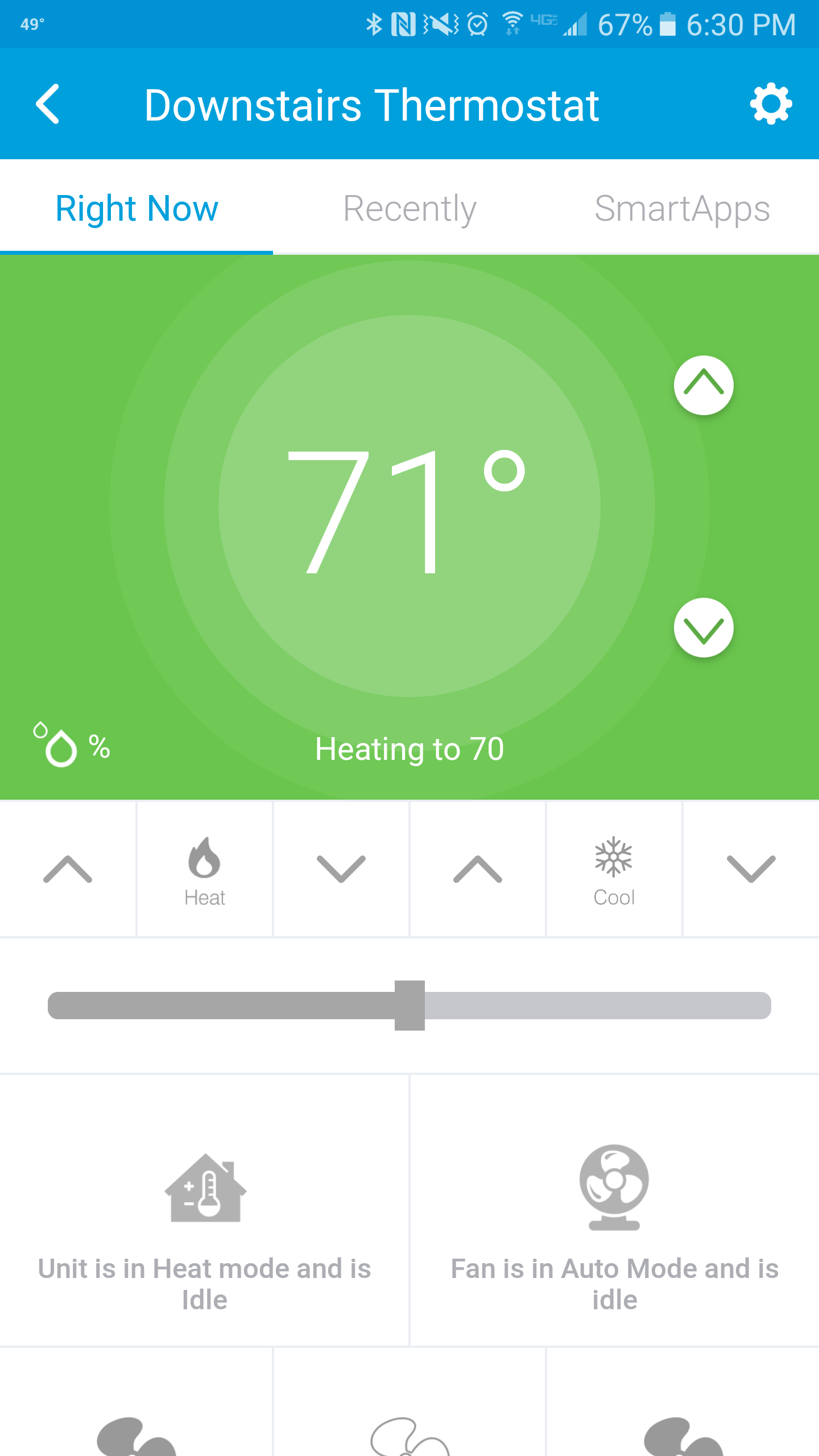

ST’s standard Z-Wave Thermostat device type works perfectly, but I prefer to use my own that replaces the sliders and adds text to the temperature tile.

I’m not sure when you captured the code for the device type, but I updated it last night to include 2 new tiles. One is for the Unit’s operating state and the other is for the Fan’s operating state. Now you can just bring up the thermo in the app and see everything instead of looking at the Activity tile for those two states.
