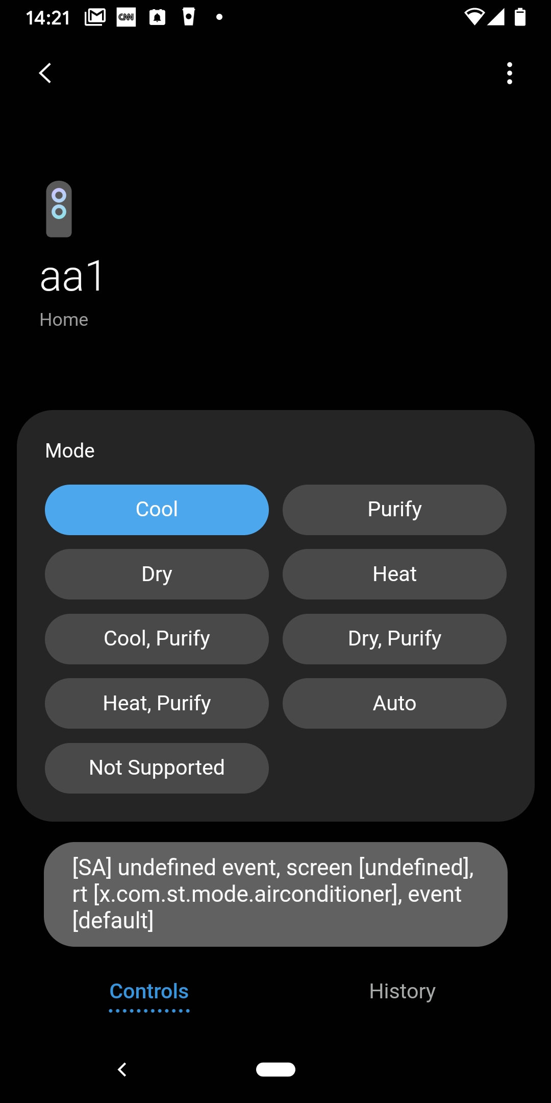

I have a custom DTH that uses the Air Conditioner Mode capability. All works fine in the classic app and it does work in the new app as well. But in the new app, I also get a brief popup error message: “[SA] undefined event, screen [undefined], rt [x.com.st.mode.airconditioner], event [default]” whenever I click on one of the mode buttons.
I have tried a fair variety of things to make the message go away without success. Any suggestions? I’m new to the new app UI so it might be something pretty simple I have missed.
Screen grab of the error:
