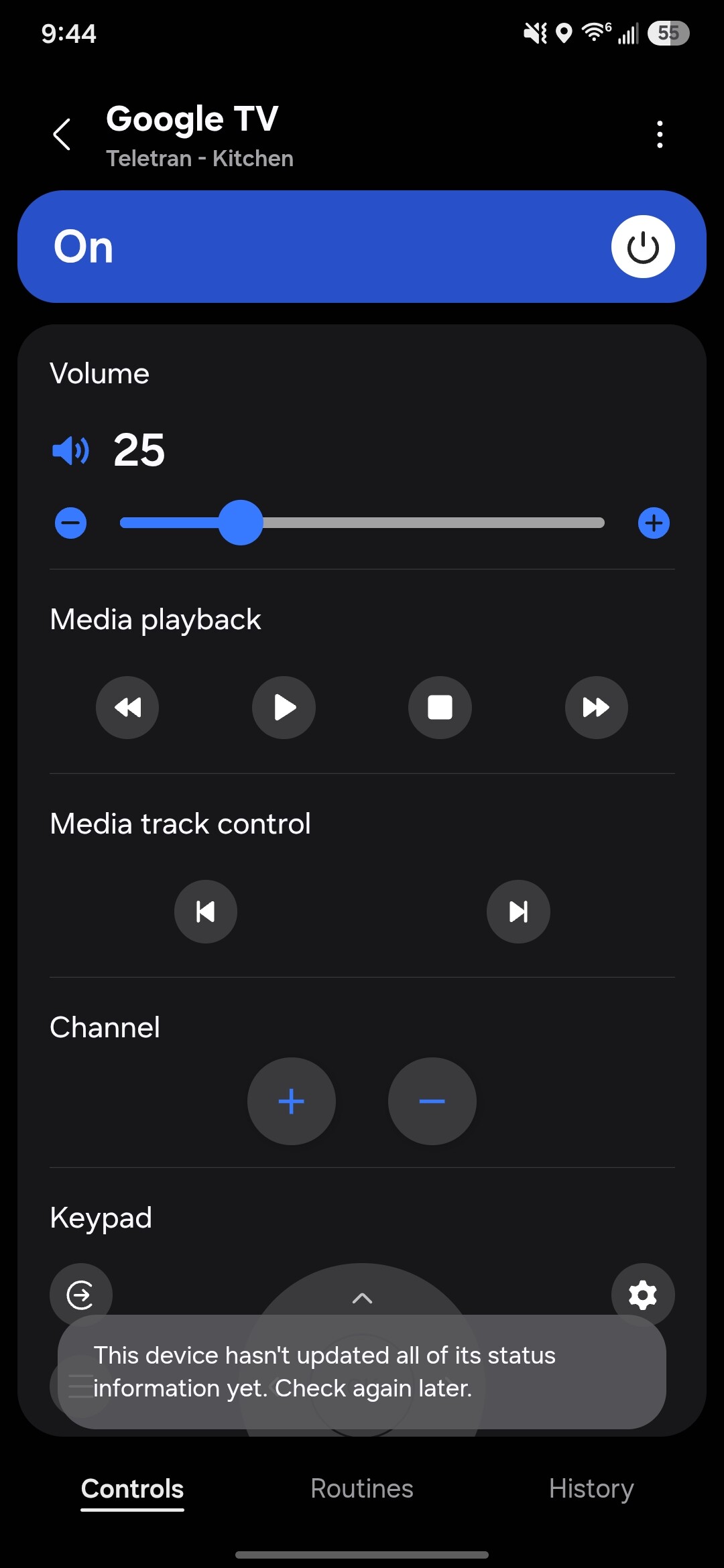

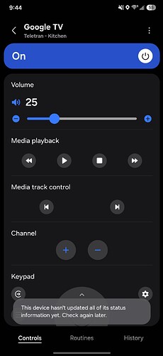

Any way we can automate a routine for it to jump straight to the Home page or to start the screen saver? Also, whenever I go to the device, I get this message
Wajo357Joey W.
You can ignore this message, I see it as well but everything continue to work fine.
