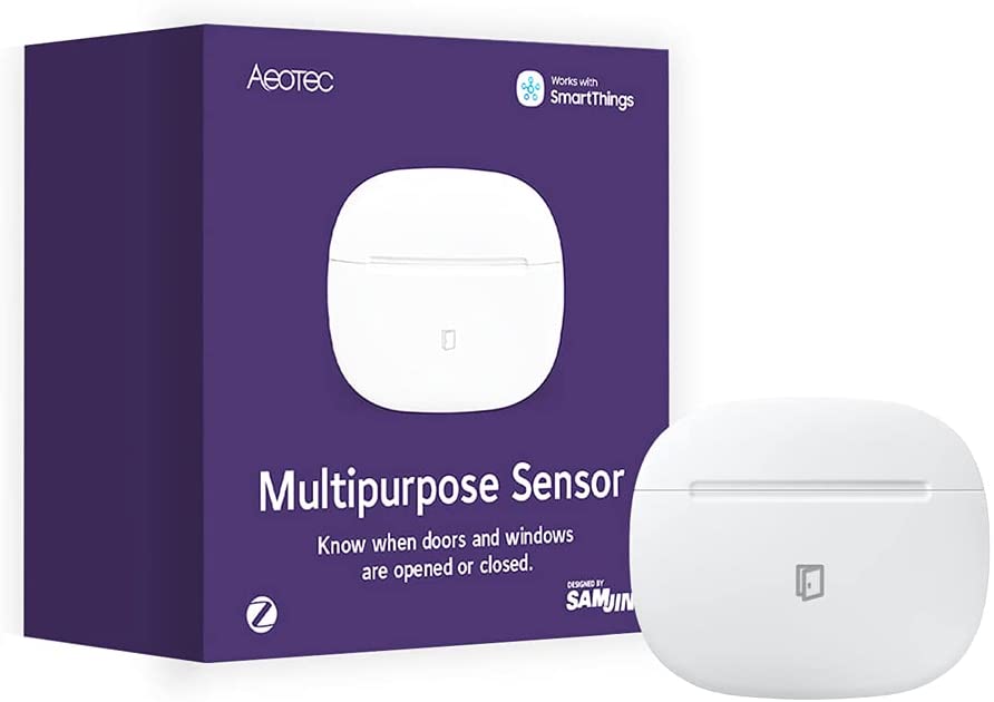

Hello Mariano,
Is this great driver available for Smartthings multipurpose sensor? (contact sensor)
A virtual version of this driver would be also a great help to control spaces with more than one temp sensor.
Thank you.
It is not added, but if you are interested I can add it.
Is the model made by samjin? I have 3 of these and could try it.
https://www.amazon.es/Aeotec-SmartThings-Zigbee-Sensor-Multiuso/dp/B08RG4NVM9
It would be necessary to create a new profile, 2 vids and two subdrivers if the acceleration capabilities and 3 axes are maintained.
It would take a few days, now I’m a bit busy with outdoor activities!!

I have two kind of ST multipurpose sensors:
firmwareManufacturerCode: 4362
manufacturer: SmartThings
model: multiv4
zigbeeNodeType: SLEEPY_END_DEVICE
Raw Description 01 0104 0402 00 08 0000 0001 0003 000F 0020 0402 0500 FC02 01 0019
And this one:
firmwareManufacturerCode: 4673
manufacturer: Samjin
model: multi
Raw Description 01 0104 0402 00 08 0000 0001 0003 0020 0402 0500 0B05 FC02 02 0003 0019
Thanks again.
Hola Luis,
Well, since it’s very hot, I stayed home and modified the driver. :wink:
I added the subdrivers and profiles to keep all the functionality of the multiple sensor, contact, acceleration, 3 axis and garage door.
I have always thought that doors and windows are not a good place to control the temperature, but each one has its needs for use!
I have already tested it with the Samjin model, you will also try it with the samrtthings and if it works well I will merge it with the published one
Driver with multiporpuse sensors for test

Hola Mariano,
I have tried to change the driver in both models but with no luck. I have updated the driver with CLI, removed app cache and restarted mi phone but the new driver doesn’t appear in the list.
Looking in another device I see that my driver is still in versiΓ³n 2022-05-17T15.
I don’t Know what I’m doing wrong.
I can’t find Zigbee Temp Sensor with Thermostat-contact driver in your channel.
Sorry, try now!
I don’t know what happened, he’s sure he had posted it on the channel
Has a different driver name
β”Œβ”€β”€β”€β”€β”€β”€β”€β”€β”€β”€β”€β”€β”€β”¬β”€β”€β”€β”€β”€β”€β”€β”€β”€β”€β”€β”€β”€β”€β”€β”€β”€β”€β”€β”€β”€β”€β”€β”€β”€β”€β”€β”€β”€β”€β”€β”€β”€β”€β”€β”€β”€β”€β”€β”€β”€β”€β”€β”€β”
β”‚ Name        β”‚ Zigbee Temp Sensor with Thermostat-contact β”‚
β”‚ Version     β”‚ 2022-05-21T16:43:10.577748                 β”‚
β””β”€β”€β”€β”€β”€β”€β”€β”€β”€β”€β”€β”€β”€β”΄β”€β”€β”€β”€β”€β”€β”€β”€β”€β”€β”€β”€β”€β”€β”€β”€β”€β”€β”€β”€β”€β”€β”€β”€β”€β”€β”€β”€β”€β”€β”€β”€β”€β”€β”€β”€β”€β”€β”€β”€β”€β”€β”€β”€β”˜
Hola Mariano,
Installed in both models and workkng perfect. I agree with you that windows and doors aren’t the best places for temp sensors, but this is a great help for me anyway.
Thank you for your fantastic work again. This driver is the most practical I’ve found.
I’m glad it works!!
Then I publish it as a new version of the Mc driver and so you only have one driver installed.
Do not change the driver and it will update themselves to the new driver.
If you have any sensor in the Mc driver you will only have to make a Change to new driver or change it to this one.
Saludos
