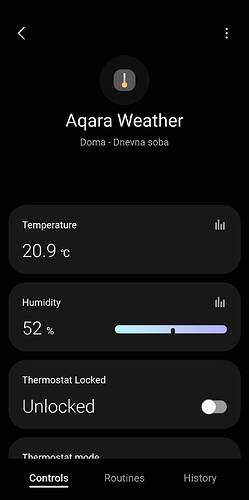

Mariano, so I have the situation like on the picture below. Two other sensor are about the same, aqara telling me that it’s hotter in my living room than those two sensor shows.
I noticed that aqara obviously has very looong respond time to temperature changes. This is probably the nature of the sensor itself right?
Sometimes it doesn’t react at all for like half an hour or even 1 hour, although the temperature has changed. If I then blow some air into the sensor , it instantly reacts so its working :slight_smile:
Hi @Spektr
I have no experience with aqara temperature sensors, but I’ve seen on the forum that it reports being difficult to configure.
I use srnsires Sonoff SNZB-02 and smsrttings, aeotec(samjin) and they work and the reports are configured very well for ysar comi Thermostat.
They report changes of 0.1Β°c, every 5 minutes if there is any change.
The fact that it does not indicate the same as other sensors is normal.
correct the temperature in preferences to what you think is correct.

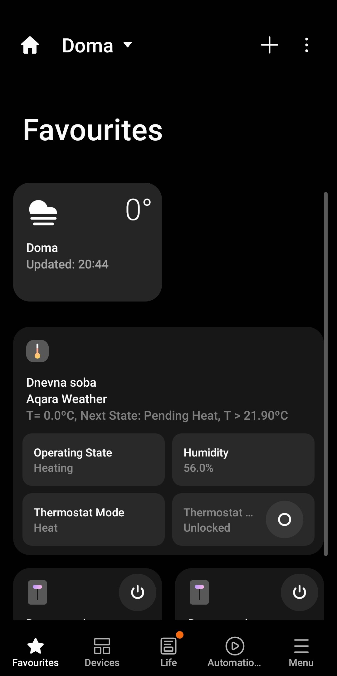

Mariano, what could be the cause that aqara sensor from time to time returns 0 degrees Celsius?
Sorry, I don’t know what could be causing that.
That case has not occurred to me with other brands of devices
Cold weather :smiley:
