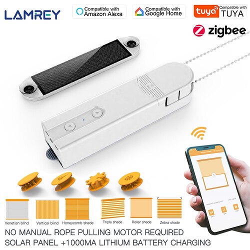

One more question.
Do you know any edge drivers for this device?
Thanks again.
About this I have not any driver
