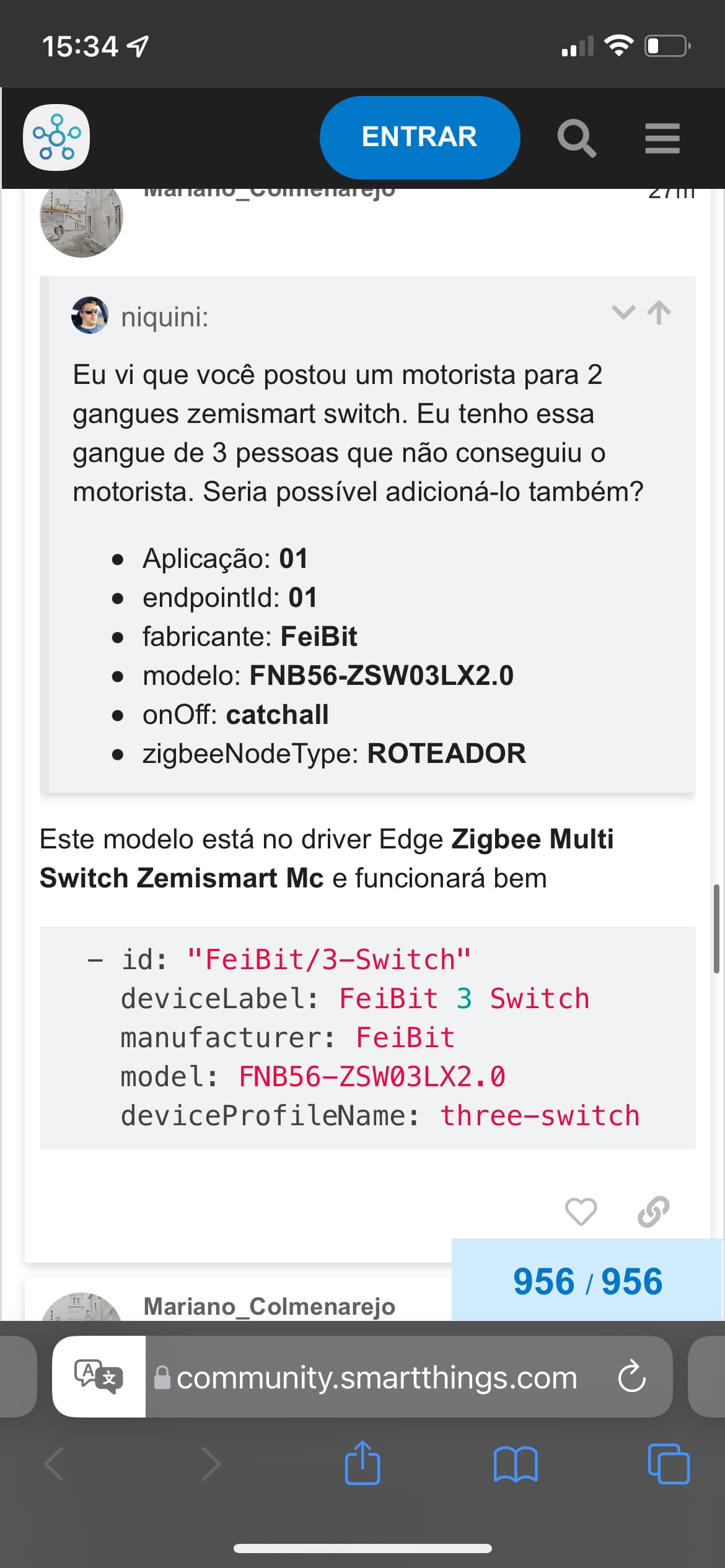

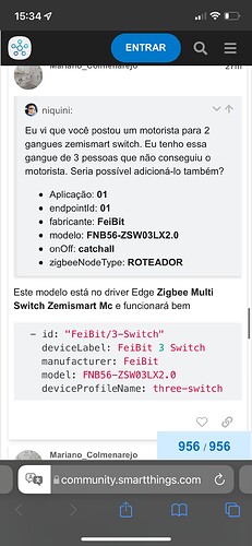

he didn’t recognize the 3 gang device
Doesn’t it pair with anything?
Nor as a thing?
is loading the old dht. but i can’t delete it because i have about 20 of them and i want to change them little by little. is that why?
Yes this is the reason.
Enter in IDE DTH and put // prior of the fingerprint of the switch, save and publish for you.
       // fingerprint endpointId: "01", profileId: "C05E", inClusters: "0000, 0004, 0003, 0006, 0005, 1000, 0008", outClusters: "0019", manufacturer: "FeiBit", model: "FNB56-ZSW03LX2.0", deviceJoinName: "Zemi ZigBee Switch 1"
The others paired switches will continue to work.
This will make the new switch not recognize the DTH
