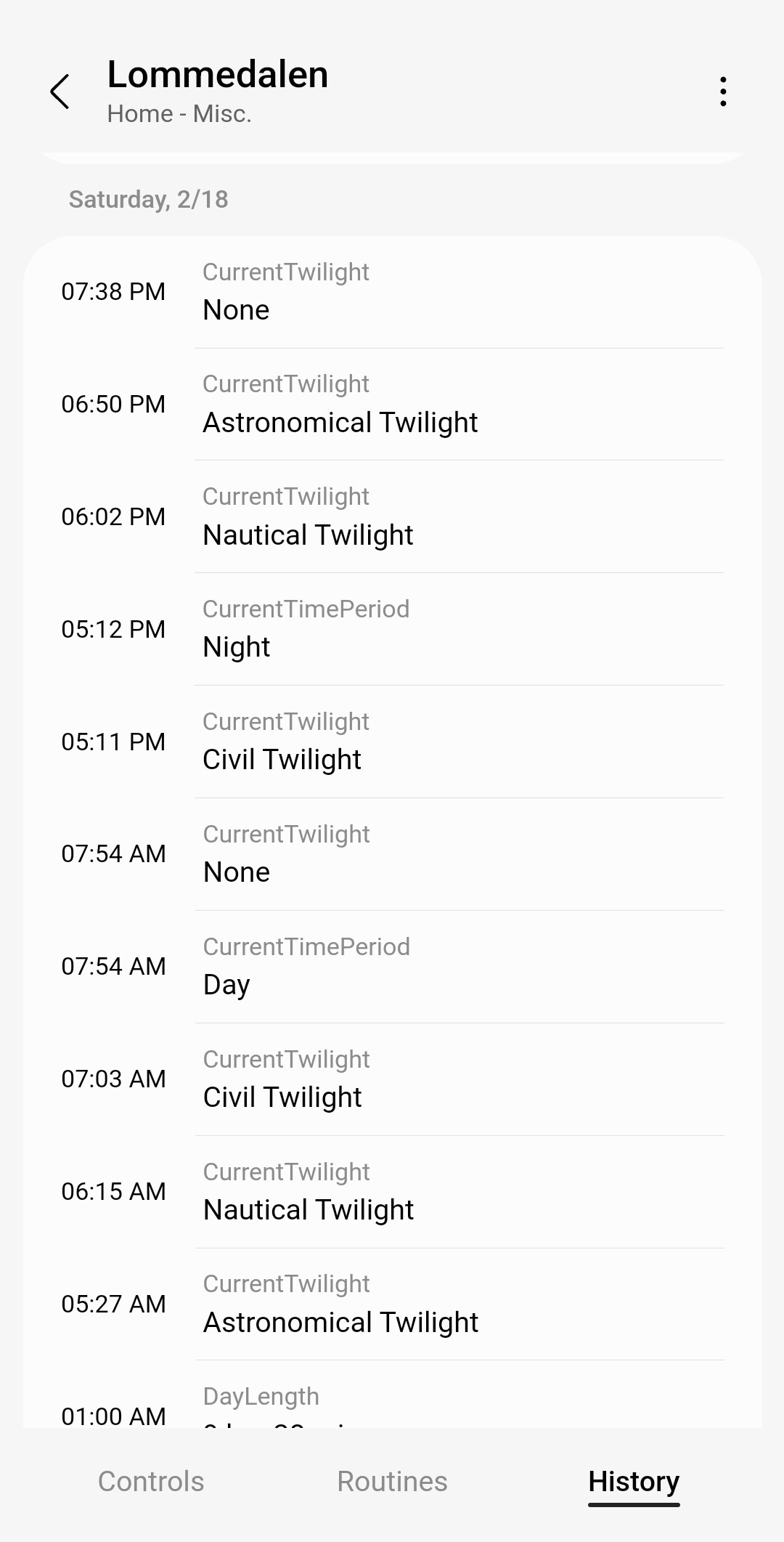

@Mariano_Colmenarejo
This routine won’t fire off, any idea why?
In history, it shows Astronomical Twilight happened at 0650 pm, but no notification was sent, and the blinds didn’t close.
A routine with current time period: Night sent a notification as it should
Hi @Geir_Skalvik
Thanks for report this issue
now the valures wil be :
“Civil-Twilight”
“Nautical-Twilight”
“Astronomical-Twilight”
I have fixed it in this version of the driver.
You will have to redo the routines, sorry.
