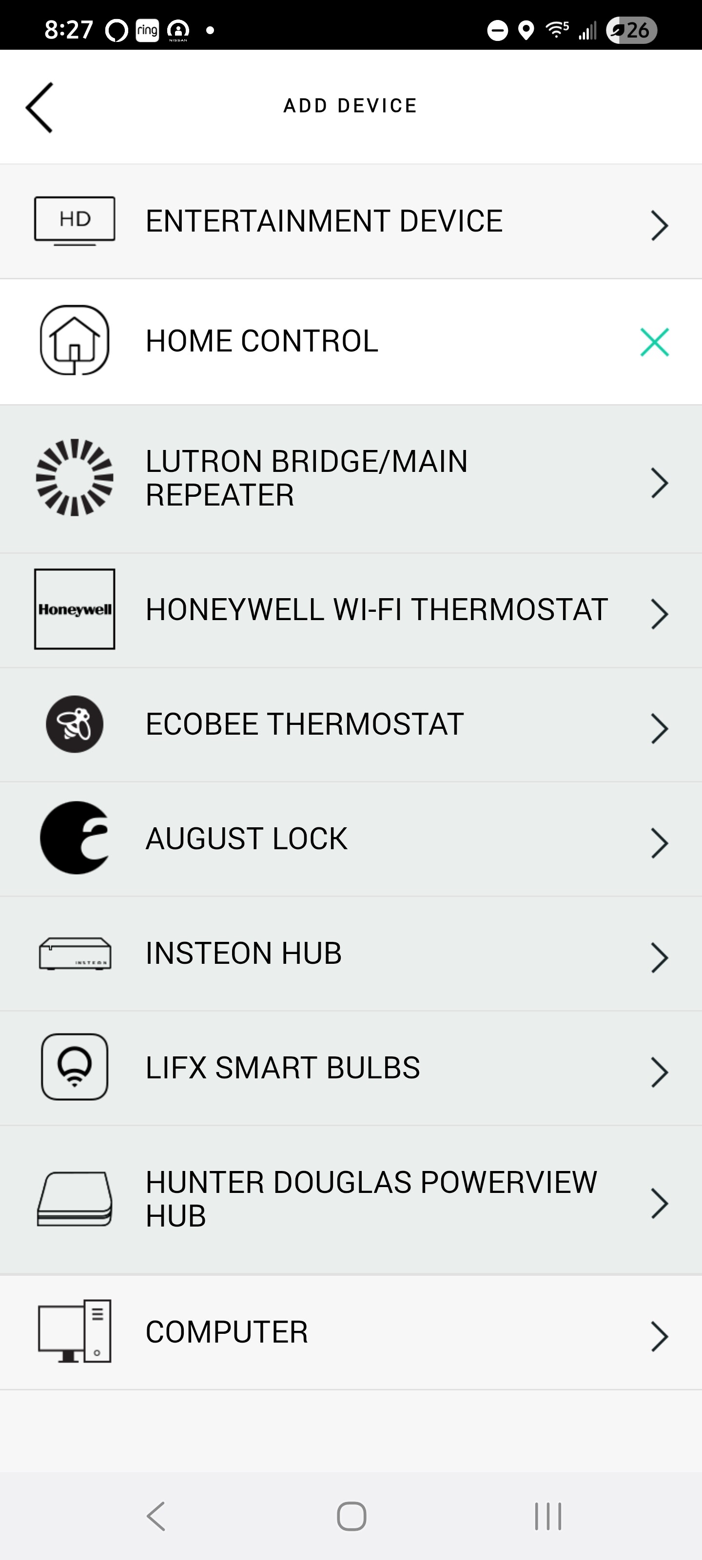

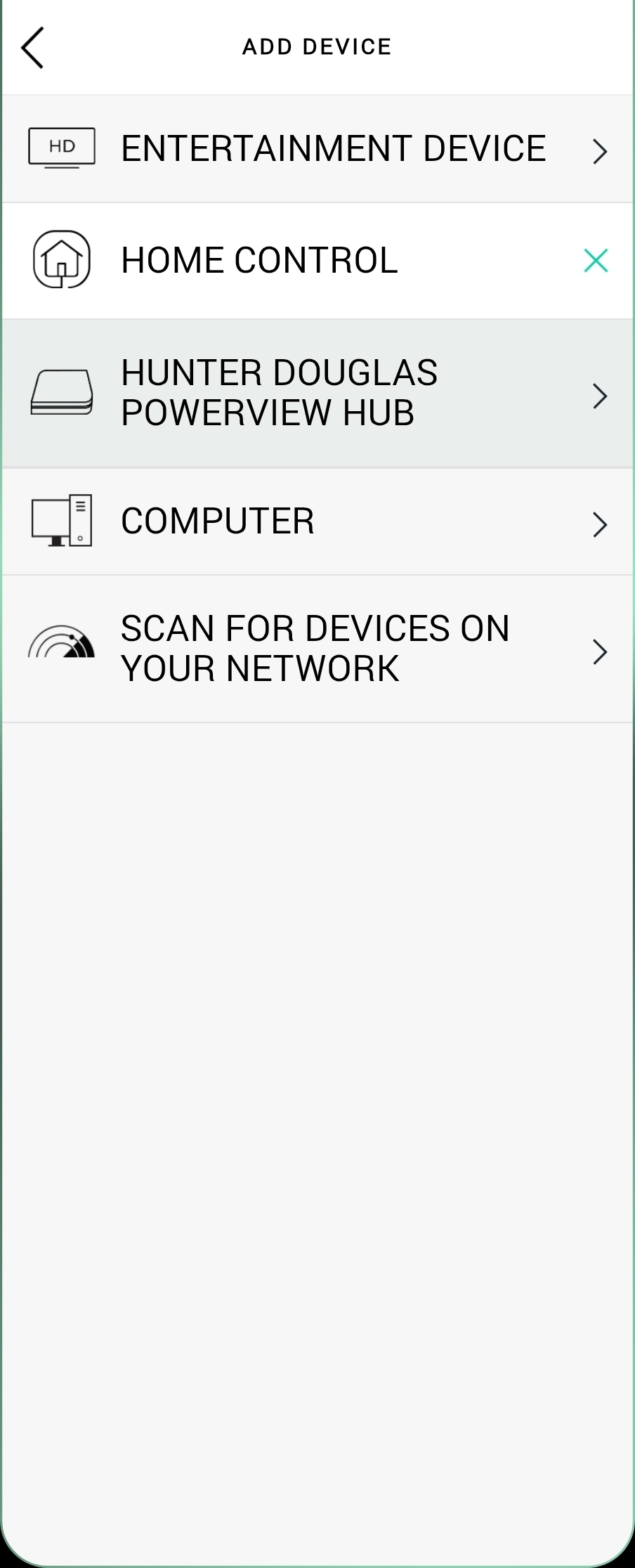

I was very excited about this news, but I’m unable to see the smartthings integration in the Harmony app, I’m missing something?
I think you probably already have Smartthings installed and it’s under your list of existing devices. From there, I needed to unlink and relink the ST account to get a full list synced devices.
Nop, I do not, I think I unlink it years ago when it became non functional.
Interesting. I also didn’t see ST when I try to add a new device but I assume it was because mine is already set up. Now I wonder if that’s true. I won’t be testing that theory any time soon… I don’t want to lose my integration.
However, I noticed you have less options under Home Control than I do regardless. Maybe you need to update your Harmony app? Or maybe your Harmony device has more limitations than mine? IIRC there were device limits depending on the Harmony product.
