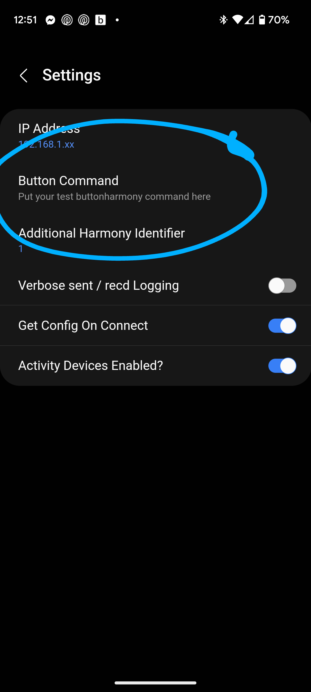

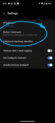

One question though, I’m not able to add a command in the settings to work with the momentary button. It says to paste the command there but no amount of clicking reveals a text input box!
Yes, that is a known fault
The momentary Vuitton is only really used for testing commands, what was you hoping to do with it?

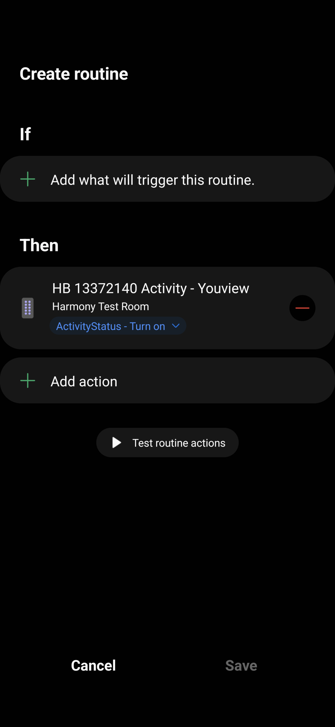

And I also managed to use device actions in routines.

Edit: I didn’t think of this at first but an even better way for the example you provided would be to turn on activity devices, and instead of sending the command just turn on the activity device with a routine - that way the device label it is performing action on will be visible - this wont work for direct device commands, but would work for the example you provided
