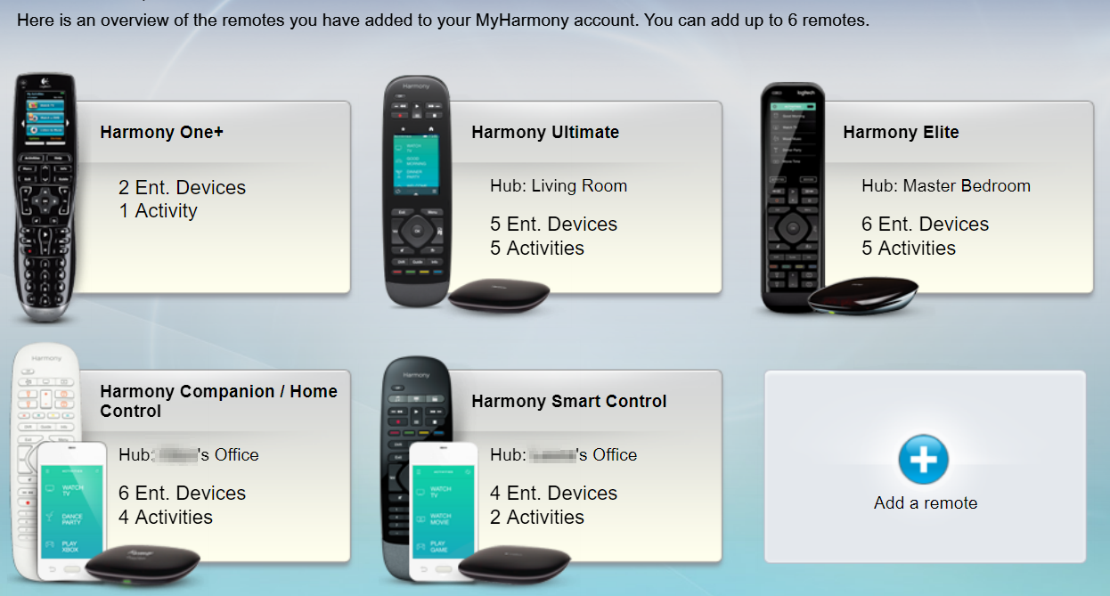

I’ve five remotes, two tablets and three phones. No matter what is on, or how it was turned on, if I hit the master off button on any of them, everything is turned off. Likewise if I tap “watch bluray”, amps are turned on, TV, bluray player, and pre/pro, set to bluray, and everything else is turned off. Again, regardless of what may have been on or how it got that way… all due to discrete on/off codes.
It’s simple… Ons are sent to every component that needs to be on, and Offs are sent to everything not being used. Doesn’t matter what was previously on or off, the correct stuff is powered up, and everything else is off.
