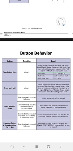

The device has a button and if you press it a certain number of times it will disable that night light feature and you’ll be able control it like a switch in SmartThings using one of the z-wave switch handlers.
@krlaframboise and @paul42 please forgive me because I’m very new to smartthings, but from the user manual found in this link (under the heading Resources): https://www.thesmartesthouse.com/products/dome-z-wave-plus-range-extender-signal-repeater-dmex1 it has some advanced settings that make it seem like there some additional settings available if you know what you’re doing. After reviewing it seems like it’s just on/off ambient light thresholds and not light intensity though
I wrote a handler for this device on a different platform and those configuration parameters didn’t appear to do anything so I asked the manufacturer about them.
They confirmed that those configuration parameters don’t do anything for the production model and said they shouldn’t have been included in the manual.
