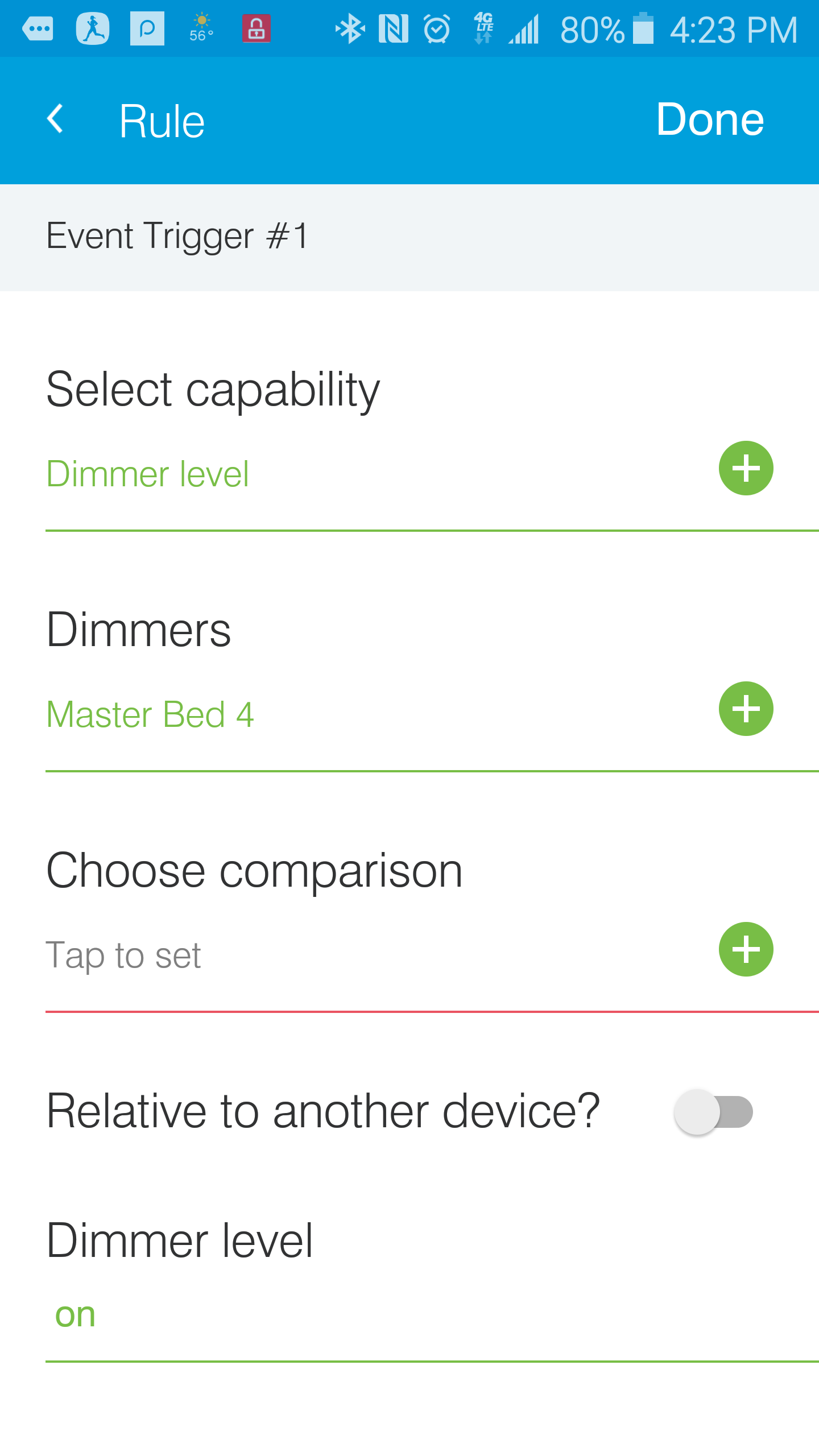

I get stuck when it ask to fill in this screen. (It is asking for a comparison Dimmer and don’t get the logic on what to compare. Without filling in the comparison information it won’t let me complete the screen.

Compare the level of the selected dimmer to a number or to another dimmer device.
So, depending on what you’re trying to do, you could use a comparison that’s always true, like < 100. You’re probably creating the condition just so you can track the dimmer level. But, you have to be careful, because a rule only does things when truth changes.
So, perhaps a trigger would work? Trigger event is dimmer level, again < 100. So any change in dimmer level is going to fire this. Action is set dimmer level, track event dimmer. Track event dimmer means to set those dimmers to the current level of the dimmer that fired the trigger.
You can use this with a group of dimmers if you want, where any one of them can change all of them.

Thank you, could not figure out that I have to provide a always true condition for compare clause. Got it to work. There were some pitfalls in Action section as well. But got it to working by now.
