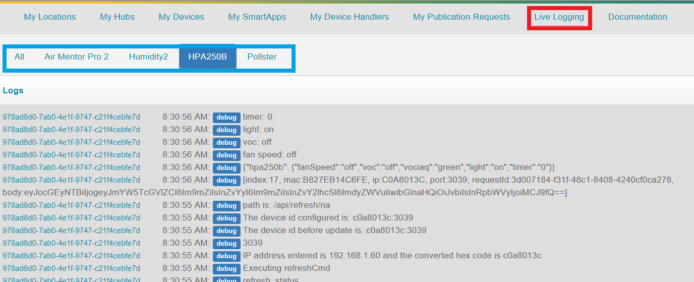

Live Logging is a logger provided by the IDE, see the red frame. The great thing is that this is way more synched than the app and you can jump from devices logs directly. They will appear in the order of the logs (the log.debug or log.info in the code of a smartapp or a DTH) as you see in the blue frame here. You can mix all devices logs by the “All”. One big limitation, the log lives only if your browser page is refreshing. If you close it, previous logs are lost in live logging but you can still get the event list going through the My Device list of the IDE.
In the live logging, the blue UIID on the left of the event can help identifying which device is showing the logs in case you are using the “All” option.

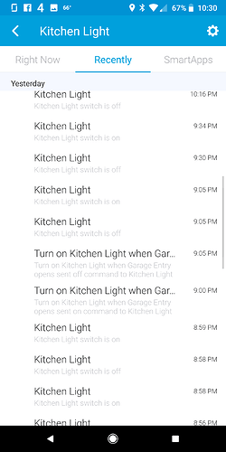

App just said light turned on. These bulbs are on a switch so they do not turn on when power is lost or connection is. I have 250 devices and know how each act. The lightify lights are unpredictable always has been but the switches have been rock solid. The smarrthings multi purpose sensor sucks. Battery drain and report of percentage for battery. I will get iris window sensor much more reliable. Smarthings Water sensor great. Motion detector good except the same battery holding flaw. To loose and causes issues. Again I like the iris or aeon motion. Also tells you more info. This is an issue with smart lighting Automation period. I had a few but I redid all of them and I have an issue with some not all. So far 3 out of the 15 or so I have set up. I have attached screenshoots. When a command is sent it says so. Like the one turn on when garage door open. Or the last when I talked Alexa to turn off the damn kitchen because all 5 lights were on.
