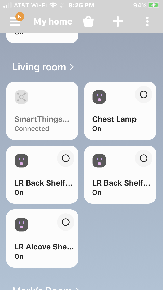

Now, the ST hub is still grayed out but it says it is connected. And… the faces are still frowns but they are in color now and operable. I think they were outlet icons before. The light and the living room group (outlets) are all represented by proper colored icons.
Is there anything else I should do to get rid of the frowns?
