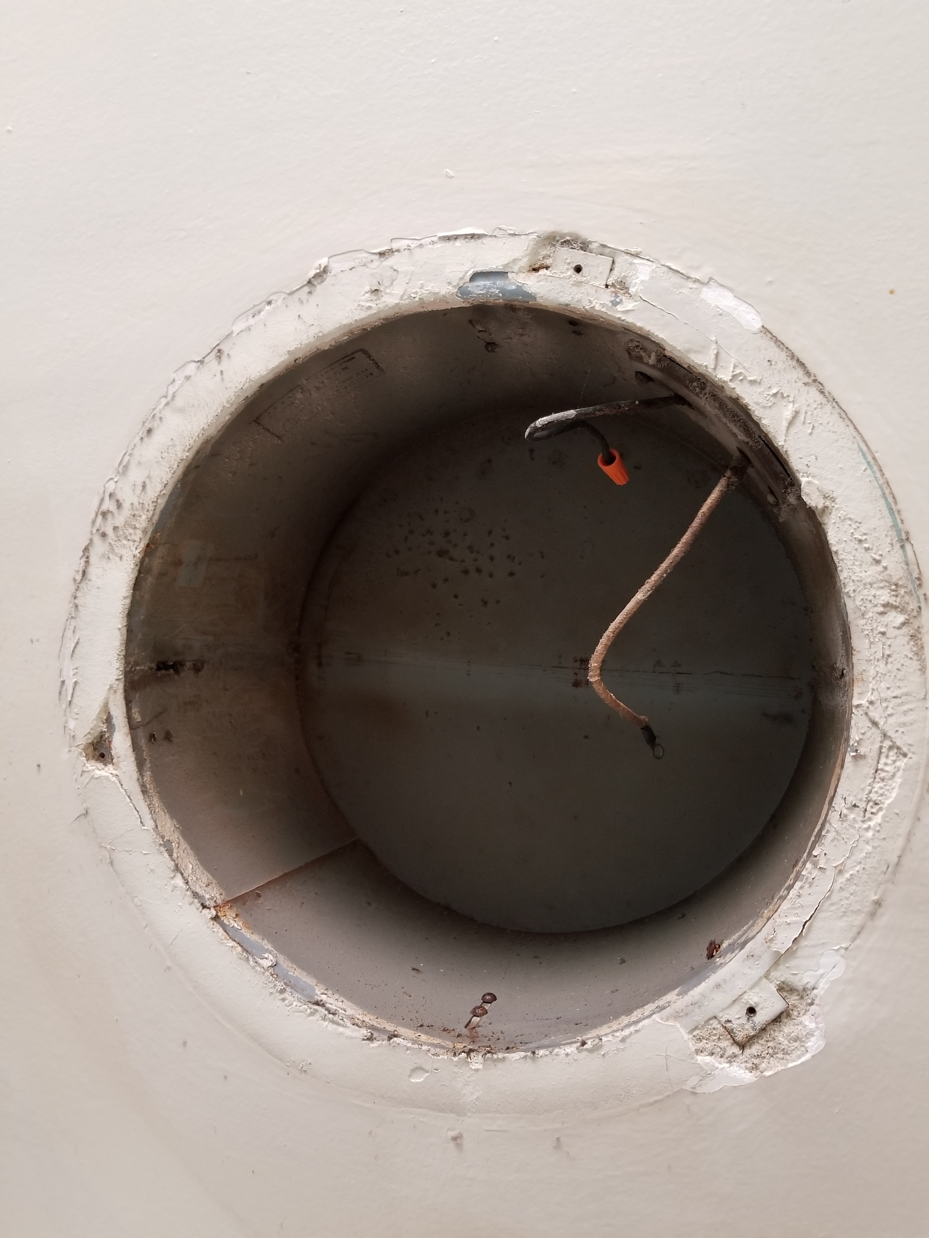

On the up side, the neutral for the heater circuit is not very far.  It’s just up at the heater.  So, what is coming into the box is most likely a Neutral for the light circuit and the Hot and Load for the lights.  Then you have the hot and load for the heater.  The Neutral for the heater circuit is at the heater.  So the electrician would just have to run a neutral from the heater to the switchbox.

Thank you for the explanation. It is very clear to me now. Several months ago, the ceiling heater had to be replaced – and I took a picture of the opening while I was waiting for the new one. Sure enough, there is a white wire up there.
