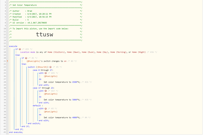

Is there a problem with using a global variable as a device and using it on the IF statement? I get this message on this piston:
This piston does not subscribe to any events. Unless executed by other means, it will never run on its own.
Logs:
6/5/2017, 10:56:16 PM +373ms
+7ms ╔Starting piston… (v0.1.0b7.20170603)
+413ms ║╔Subscribing to devices…
+575ms ║╚Finished subscribing (167ms)
+668ms ║Comparison :d38f6ac2191be6c6ad255146e4de50e9: is_any_of :da177b1cec0aa4db858b18a1ceb022df:,:44c731ae91e1794ded66019ec94612d4:,:79cb6b14b6de2e6cb6d58d2acc15a2ad:,:06bc5124204f706ab4ad2a6c6dad362d:,:5a13bc06c89b3ff0de08e6211158be54:,:4dc25676f7d61ce0f0071842b865cde4: = false (14ms)
+712ms ║Evaluating switch with values [[i:5:null:0, v:[t:integer, v:22, vt:string]]]
+724ms ║Comparison 22 is_inside_of_range 0 … 17 = false (5ms)
+744ms ║Comparison 22 is_inside_of_range 17 … 23 = true (4ms)
+781ms ╚Piston successfully started (776ms)
