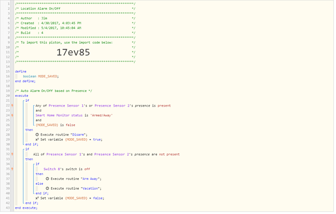

I’m still having issues with this piston. The 2nd half seems to execute multiple times. Below is the piston and below that is a portion of the log showing what it did. I am assuming I need to set the execution condition but not sure where.

Continuation of my previous post. The first part of the piston which disarms the alarm when either my wife or I arrive. If we happen to arrive within a few seconds of each other, which occurs due to the location not being precise on both our phones, I used the variable to prevent the piston from executing twice. And that works ok. The problem is if we set the alarm from another method then the variable doesn’t get changed. Any ideas on some other way to write this piston?
I could tell you how to fix it but I want you to figure it out yourself, so here’s a hint:
Without looking at the piston, figure out which events are the important ones, which events you are REALLY expecting. Make note of them, then look at the piston and look for all the orange bolts. Do they match your requirements?
Second hint: you can inhibit unwanted events in two ways:
  1. convert the important events to triggers, leaving the unwanted ones as conditions
  2. leave them all conditions but alter the Subscription method for the conditions you do not want to subscribe to events, by setting it to Never subscribe.
Let me know if tou figured it out.

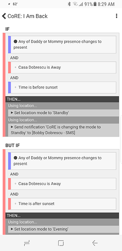

I haven’t had a chance to convert this to WCORE, but here is one that has worked flawlessly for months for us…
How exact does the phrasing have to be with that? I.e. can you say “run the sleep routine” or “run sleep routine” and it will resolve the same? I will be able to remember exact but worry it will frustrate the wife. With the just switches it seems to be I can say “Turn off master bedroom” and my wife can say " Turn off the master bedroom light" and both resolve ok.
Then again I am the only one who will thing to run this routine so maybe in the end it doesn’t matter lol.
