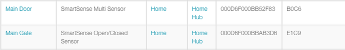

Btw, I can’t get Ask Alexa to report the contact sensor status but no problem with other devices. Kinda strange.
My door sensor called “main door”, but Alexa refuse tell me if my door open or close :joy:
Some non-standard devices (off brands) have this issue…what brand is it? Can you send a screen shot of the device itself within the IDE and the interface in your mobile app. Also, if it is a customer device handler I will need to see that code as well.
One of them is ST Multipurpose sensor and the other is Iris Door Sensor. I’m using default handler.
Let me know what’s exactly needed in mobile app?
Screenshot of the device in IDE
So the Main Door is the one that doesn’t work and the gate does? Or vise versa? Click the device that is NOT working and show that information, please.
both devices not working.
