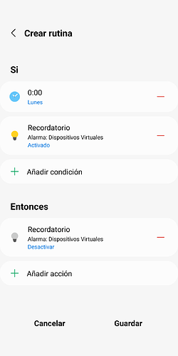

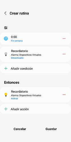

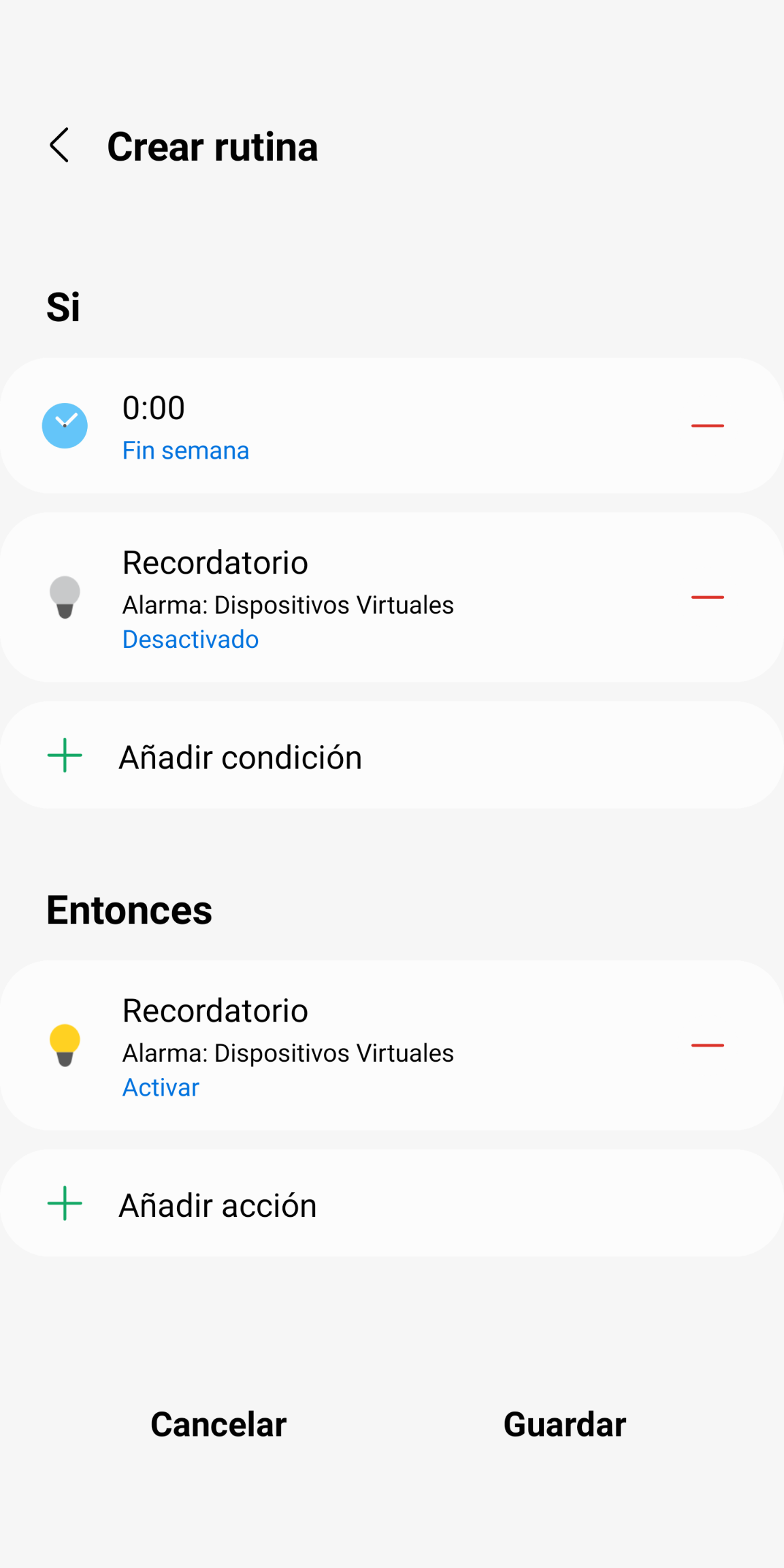

You can use routines with the previous condition of time, at any time and choosing the days of the week that you need.
If you want to use the rules API, I don’t know, but you could make a routine to activate a virtual device on weekends and use the API rules with this device
