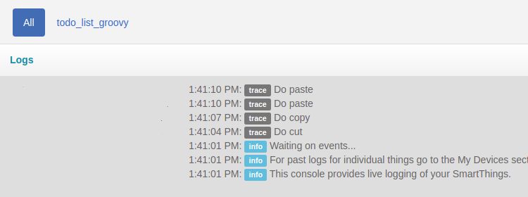

Following-up on this issue about setter commands from custom capabilities supporting the list display type, here are some IDE logs where the key has been sent as argument instead of the value specified at the capabilityās presentation.
Iām not seeing this happen on iOS. The command is never called in the IDE when the command is invoked on the UI.

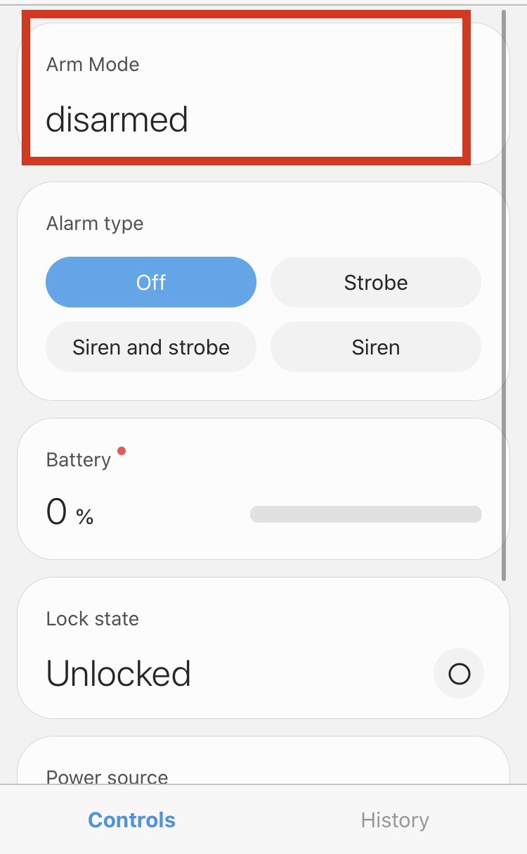

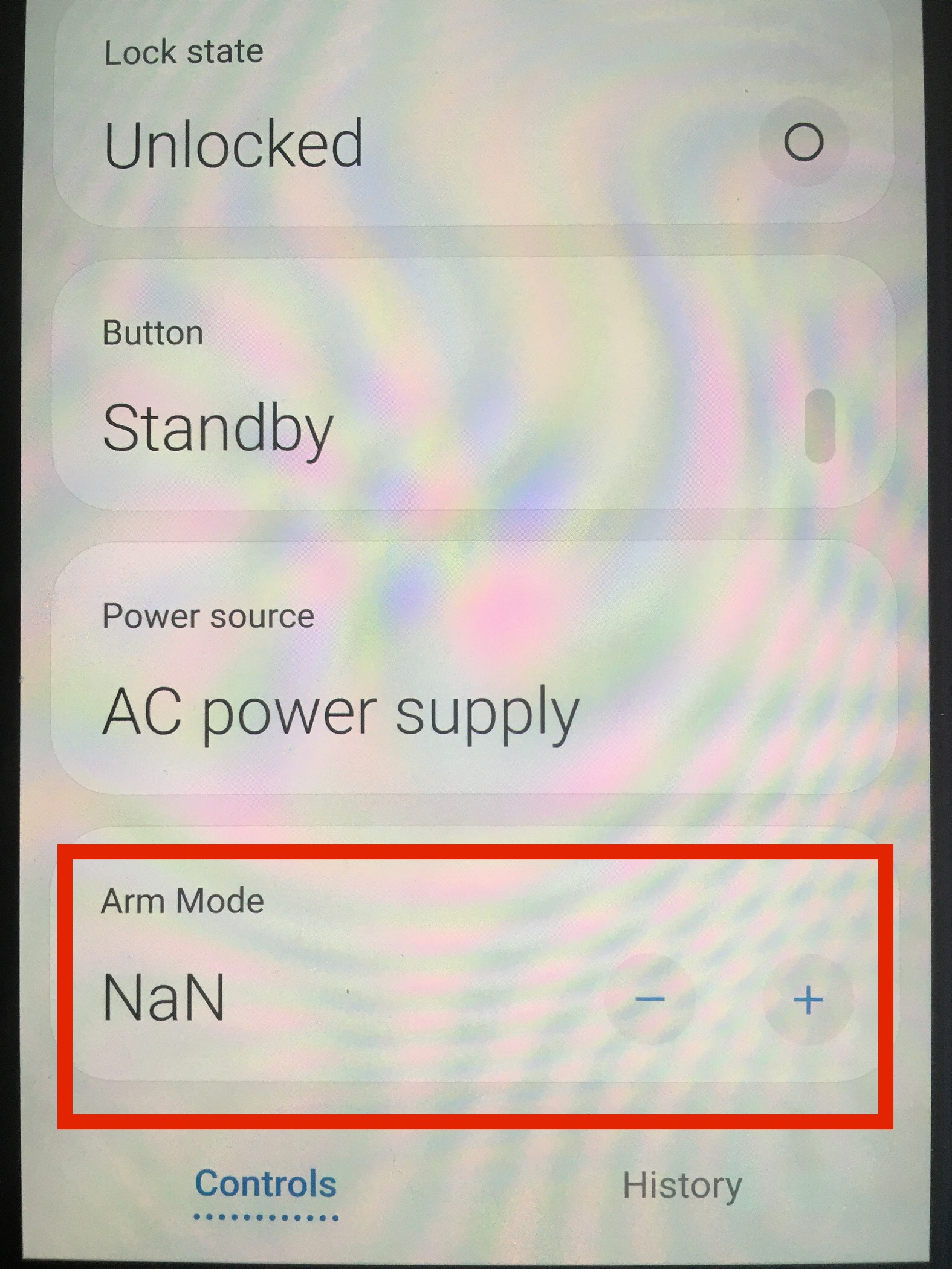

As of this week, the UI isnāt updating at all on the mobile phones. The same control is showing different UI components on Android and iOS. My iOS is stuck showing a state in the detailView where as the Anrdoid is showing a stepper. The presentation file is set to a list
Iāve logged out and logged back into the mobile app itās still completely disconnected from reality. Iāve deleted the capability completely and started over and everything is still disconnected from each other.
In short, the whole thing is a mess and nothing is working as directed/documented or even in sync with each other. I donāt know the iOS, Android and VID are showing controls which are completely different from each other?

Iām also seeing mismatch between ios and Android, even between devices using the same DH on Android.
Makes it very hard to test changes, you donāt know if the changes didnāt work or just hasnāt been updated yet
