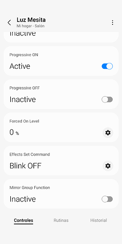

Now I can send you the logs and the captures with the capability that keeps the spaces legendabsolute60149.effectsSetCommand and that now works fine, and before yesterday it didn’t work:
  • This is the log of emit_event “BlinkOFF” in the log of can see the key (without space):
2023-02-24T18:56:52.276023523+00:00 TRACE Zigbee Light Multifunction Mc Received event with handler capability
2023-02-24T18:56:52.280977189+00:00 INFO Zigbee Light Multifunction Mc <ZigbeeDevice: 84944c69-fa8e-417e-bb62-92b7d5087d63 [0x1786] (Luz Mesita)> received command: {“args”:{“value”:“BlinkOFF”},“capability”:“legendabsolute60149.effectsSetCommand”,“command”:“setEffectsSetCommand”,“component”:“main”,"positional_args":[“BlinkOFF”]}
2023-02-24T18:56:52.299003189+00:00 TRACE Zigbee Light Multifunction Mc Found CapabilityCommandDispatcher handler in zigbee_light_multifunctions
2023-02-24T18:56:52.300546523+00:00 PRINT Zigbee Light Multifunction Mc <<< effects_Set_Command_handler: BlinkOFF
2023-02-24T18:56:52.301724523+00:00 INFO Zigbee Light Multifunction Mc <ZigbeeDevice: 84944c69-fa8e-417e-bb62-92b7d5087d63 [0x1786] (Luz Mesita)> emitting event: {“attribute_id”:“effectsSetCommand”,“capability_id”:“legendabsolute60149.effectsSetCommand”,“component_id”:“main”,“state”:{“value”:“BlinkOFF”}}
  • In the capability app you can see the value (with space):
  • in the app history you can see the Key (without space):
In feb 13 with legendabsolute60149.currentTwilight capability this was not the case and the routines did not work
