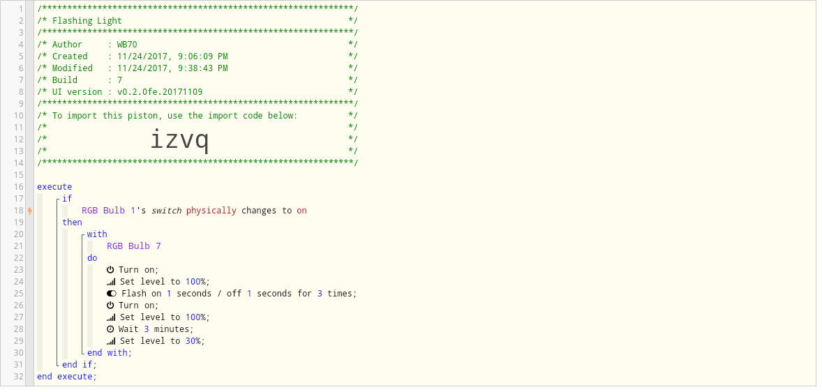

With that, based on your requirements, I set up a very basic Piston for you as a model to how you would do this yourself:
  • When Rock 1 (Switch) is turned On, do the following:
  • Turn on Dining Room Light
  • Set level to 100%
  • Flash Light 3 times with a second delay in between each
  • Turn on light
  • Set level to 100%
  • Wait 3 minutes
  • Set level to 30%
This is very basic. 1 switch and 1 light for now. I did this to give you a very basic understanding of how to do it. Once you see this, you can add additional qualifications for any of these 4 or 5 buttons and add more lights that turn on, flash, dim and turn off later to your Piston. There are a million different things you can do and you will soon find this out.
So how can you get this Piston that I created in your environment. After you install webCoRE and get all setup (all your devices added that will be used for webCoRE) and into the Dashboard, you will select Create New Piston and then select Restore a Piston using a backup code. The 4 digit code you see in the screenshot is what you will enter. You will then be asked to replace the Switch with your own (pick one for testing) and the Bulb (select one of your bulbs for testing). This will modify the Piston for your environment and your devices:
