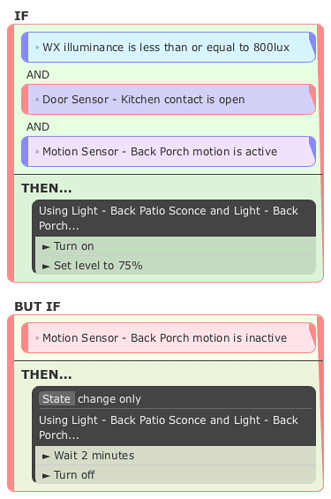

Ok I’m stumped. Here is the scenario: I have a motion sensor on back porch and a contact sensor on the door. I want the light to turn on when contact opens (that works) and then either stay on if there is continue activity by the motion sensor or turn the lights off after 2 minutes of no motion .
I tried the piston state change on latching, however the light still turns off even if there is motion.
Rick, time after x triggers twice a day: at x (when it becomes true) and at midnight (when it becomes false). That is normal. If you want things happening at x only, I would recommend using a trigger. The reason the light is not turned on at midnight is because the IF is false. It appears that sometimes the time scheduler is early, making the interval happen right before midnight - therefore turning the light on. I will fix it so that even if the scheduler is a bit early, I still consider it off.
The way you built this, the light will come on only if the door is open and there is motion and it is dark. But it can turn off if motion stops. But then if motion starts again, you’re again conditioned by dark and door open. And the door is closed, according to your piston’s red color… Maybe you mean Motion sensor is inactive and door is closed in the BUT IF?
You are using a time trigger in the IF. Try using the contact changes to open in the BUT IF. If you use triggers, they’re the only ones responsible for reevaluations. So go triggers then :slight_smile: and leave the time as condition.

That did it. Thanks!
So I should remove the time trigger from the “but if” and just use the contact “changes to open” trigger (in but if)?

Just make the door is open a trigger: changes to open.
