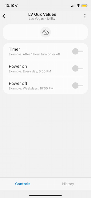

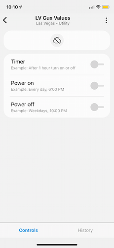

Any idea why the exact same DTH would appear differently for two different virtual devices? I actually get two that look like the right one and one that looks like the left. It’s strange.

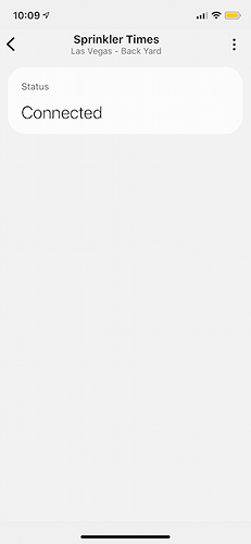

The two that display like the image on the right, are behaving as I’d expect. They are basically saying they don’t have any capabilities they know about and just falling back to displaying the connection status instead.
The device shown on the left looks like it may have picked up some crud from a close encounter with a different device type handler. In particular it looks like there could be a ‘switch’ attribute hiding somewhere and confusing things. It is the sort of weird thing that can happen if, for example, you temporarily change the device type handler using the IDE in an attempt to kick things into life (changing the device name temporarily is safer). Could something like that have happened?
