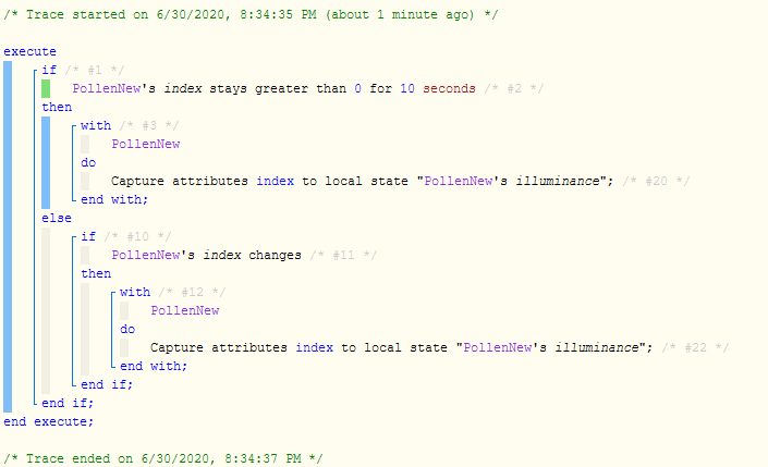

Here is what I am trying to do in webcore to populate data so that Actiontiles can use it:
Any suggestions would be deeply appreciated

You shouldn’t need anything in webCoRE at all. The illuminance should update whenever the pollen index does. Unless I missed something.
the original Device Handler does not check for any illuminance. The problem is the device value for Pollen is not compatible with Actiontiles capabilities. That is why I thought I could just get a value from one attribute and use it in another attribute that Actiontiles recognizes.
Yes, you can define a separate virtual device handler with a capability that ActionTiles recognises and then use webCoRE to subscribe to the changes in the pollen attribute and run a command to set the value in the virtual device. Nothing stopping you doing that if you want.
I was just suggesting you turn the pollen sensor into something that ActionTiles recognises and then you wouldn’t need the virtual device or webCoRE to help you out. With the changes I suggested the illuminance matches the pollen (as long as you update the device or wait up to an hour for the next poll).

That did it!! I updated the Device Handler and reran the webcore piston and it populated the value into Actiontiles tile. It still is with lux on the bottom, but that is better than a degree icon above the number. The actual value here is 2.5, so Actiontiles does not allow for decimals on lux tiles, so at 2.5 the Pollen Count is 3 (no big deal). Thanks ever so much!
