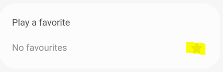

That’s why sending an empty array doesn’t change the status of the “presets” attribute, instead, you can use the following command:
device:emit_event(capabilities.mediaPresets.presets({{id="",name=""}}))
I tested it and sending that event disables the usage of the widget until it gets new data:
