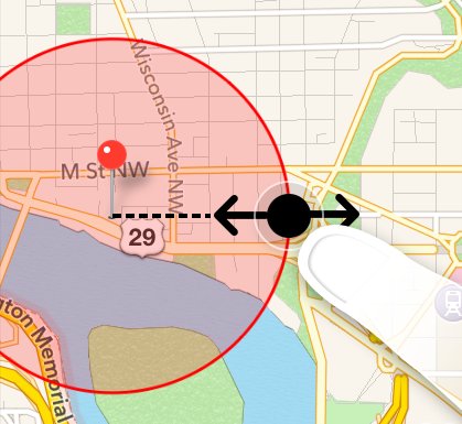

I think you are asking how to change the geofence size/location when using a phone as a presence sensor? The phone type (Android, iOS, WP) doesn’t matter,but the exact sequence for accessing the menu may. Here’s how to access on Android:
Note that the center defaults to your hub location, but it doesn’t have to.be. In my case, I live on the southern edge of a private community, and the southern half of the circle was a hillside populated by pepper trees and coyotes, which was not particularly useful. I offset the geofence center 2 blocks to the northwest and things improved dramatically.
