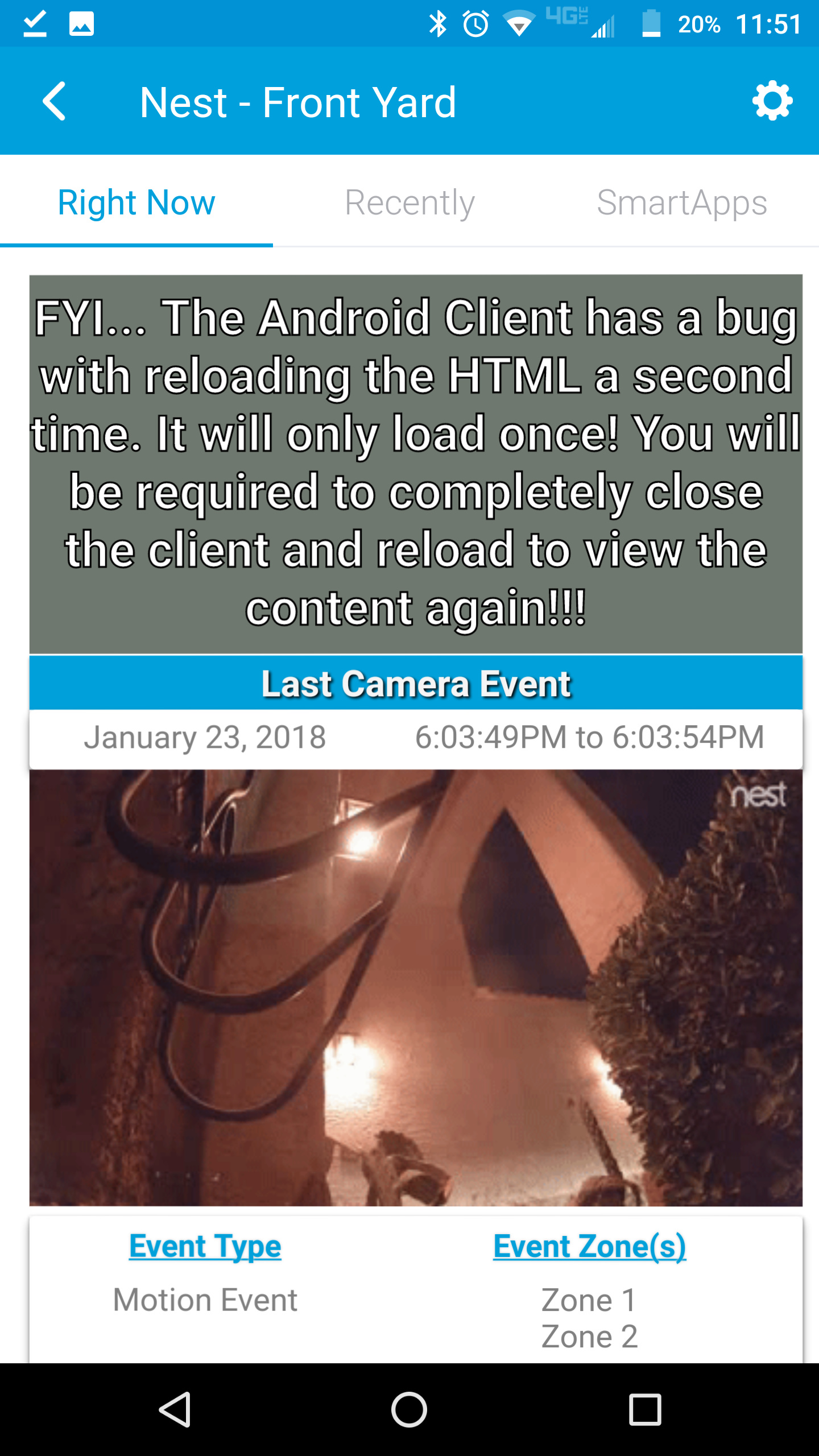

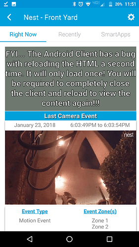

There is nothing wrong. This is a result of Android. When you open the device in Things, all you have to do is swipe down on your screen and the device info will load.
Do a search on this topic and enter spinning circle and you can see every single post about this functionality and what the issue is:
When I swipped down on my android screen as the blue circle was spinning, nothing loaded when I swipped the notifications back up again.
  1. Ah, swipping down within the app. I see the rest now but the blue circle is still spinning below it.

Perform the search I referenced and you will see when and how to get rid of blue circle. You can load device once after restarting app and there is a large message that explains it when you load the device the first time. Can’t miss it.

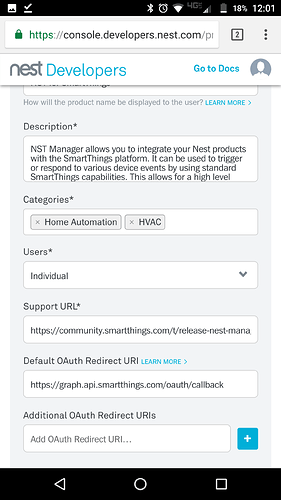

In the Nest Developer Account you created:

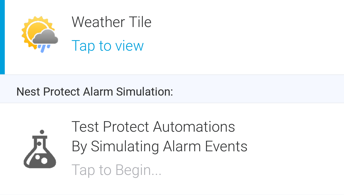

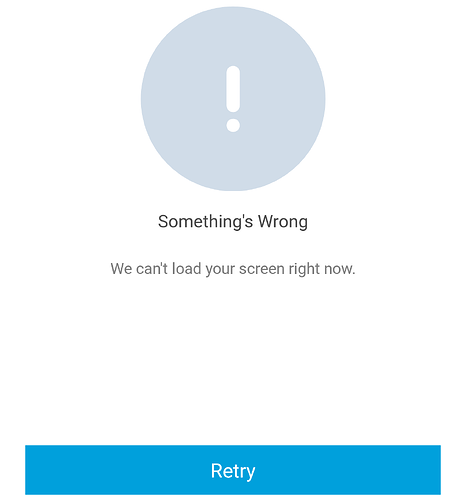

Are you referring to the “Nest Protect Alarm Simulation” under Device Selection? If so…that doesn’t work either. When I tap it, the page that shows says “Something’s Wrong” “We can’t load your screen right now.”

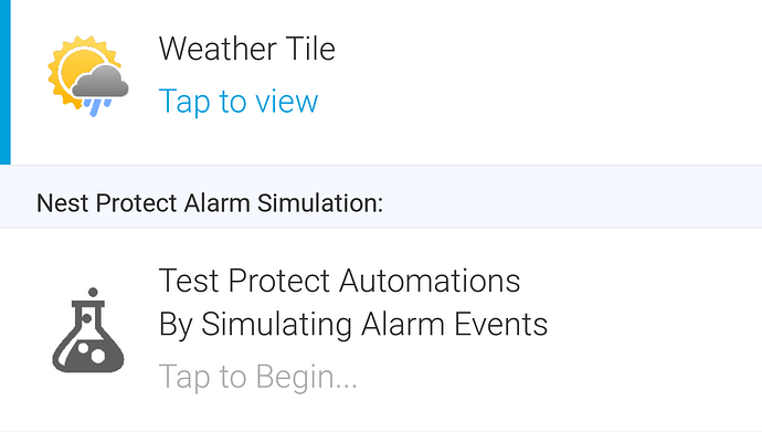

I just got home and validated the Nest Protect Alarm Simulation on Android.
I get the same result:
I had Live Logging going and nothing is recorded in the Nest Manager or Protect Logs. I turned on the Web Diagnostics page as well and don’t see anything logged in there either.
I am able to duplicate this and will have a fix out this afternoon

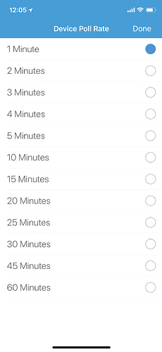

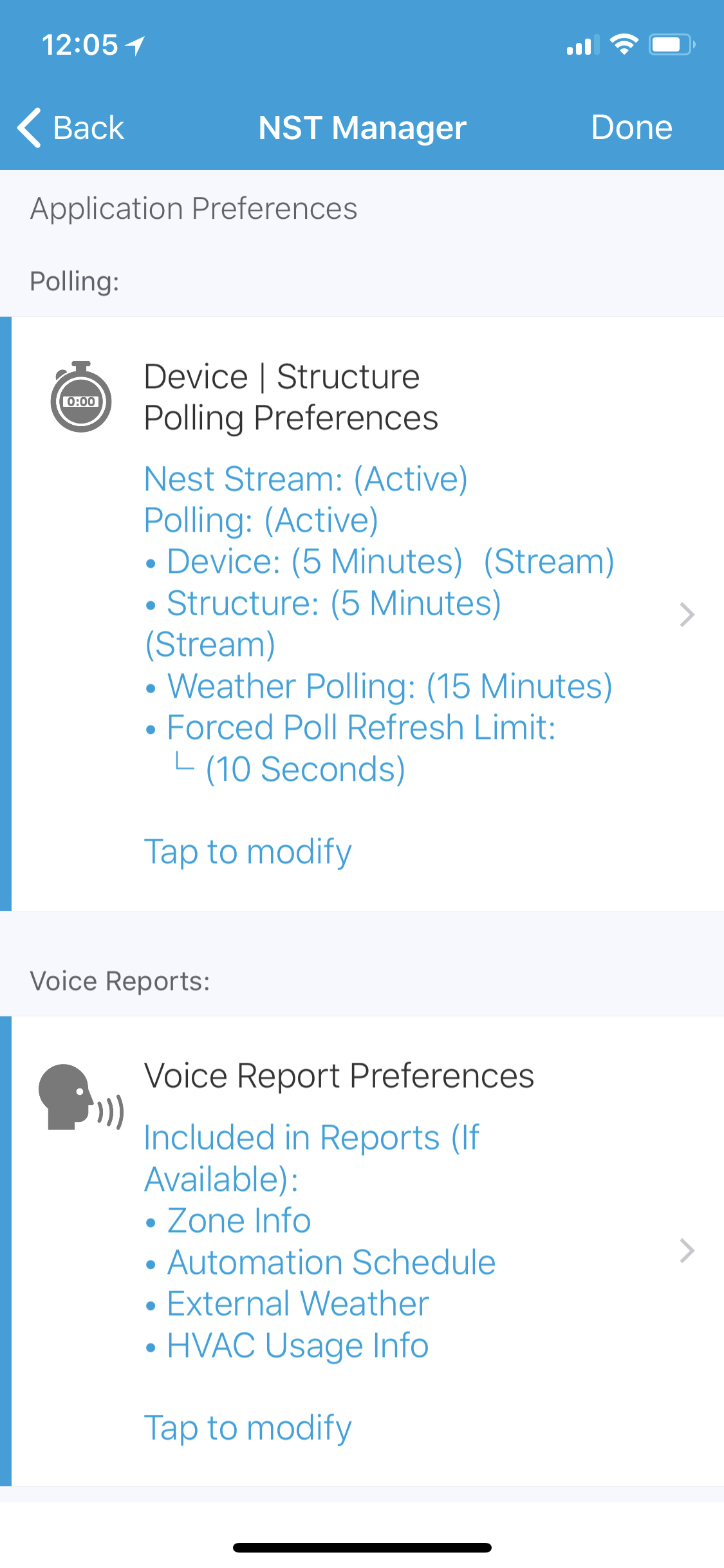

So…during the battle, it was mentioned that NST Manager can be set to poll more often? Where can this be found?
In the NST Manager SmartApp > Application Preferences > Device | Structure Polling >
