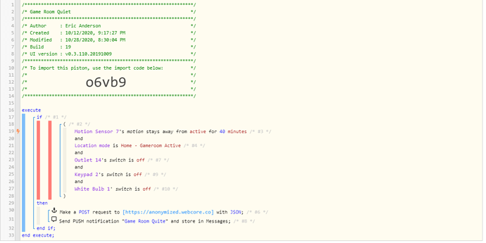

i’m using webcore… line 30 executes a scene. outlet 17 is my subwoofer, which is turned on with any off the Harmony Activities (TV). also created another home mode…
