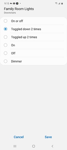

Just got my modified version of Nuttytree’s DH properly working with native double tap support. Simple edits. I see you’ve already borrowed my switchmode and minimumdim code (I was the first to share those hidden parameters and your code is an exact copy/paste of mine).
For double tap to work, change all of your numberOfButtons = 2 references to = 1. Then be sure to set the supportedButtonValues property to the values supported by your device. In this case, I’m using [“down_2x”,“up_2x”] for this one.
Once done, you can use the native automations feature to trigger your event via down_2x and up_2x. These will also be exposed to SmartLighting, WebCoRE, etc…

A couple things though before upgrading, it is a “breaking” change for anyone that was using the two seperate buttons, so any automation would have to be updated after applying the code update to use button one and either up_2x or down_2x. One other minor thing I noticed is webcore is behind the times and only lists pushed and held in its default drop downs, so you would need to do an “expression” and “up_2x” or “down_2x” to continue using the DTH in webcore. I think most would figure that out though. Screenshots below showing the change. Any feedback appreciated. Thanks again @bradlee_s for this great idea. I will work on updating the other handlers I have for the on/off switch etc to support this new method.
The previous version of this file worked for me with my sth v3 and the new app. Now that you have changed it , I can’t get it to work with smart lighting. not sure why.
I tested the new code on smartlighting and it worked on my end, but if you upgraded you will have to redo all the automations because the button numbers changed. You also might need to go to preferences and toggled “force settings update refresh” Unfortunately that was the only way to get it working with the automation screen directly (without using a smartapp) in the new app.
