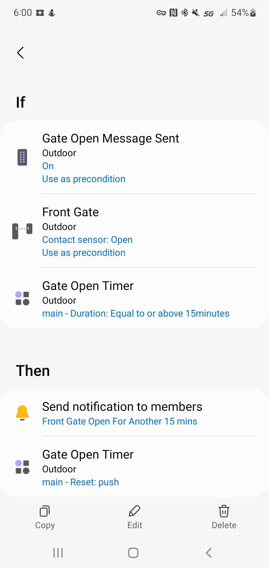

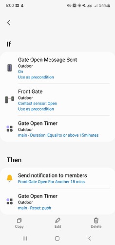

Remember, there are two parts to Routines; the triggering event and the precondition (bounding conditions/state check). Your Routine is written so that there must be a temperature event where the temperature crosses the threshold and the switch turns off when the state of the bounding conditions is within the specified time range. I think you really want the temperature and AC switch as preconditions as well and then use the virtual counter Edge driver to create a loop that then triggers your Routine every X amount of time. I use a similar method to check if a gate is left open and send a message every 15 mins.

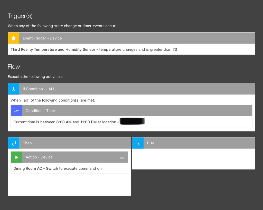

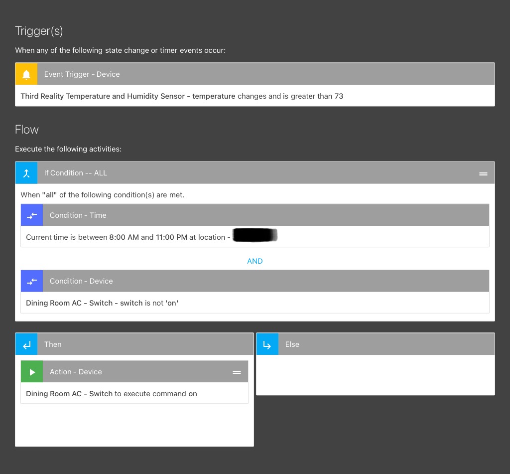

For what it works, it seems like Sharp Tools could actually work! The problem is that it doesn’t seem like I can specify a time period trigger in their rule engine (at least not in the non-paid version). However, I was able to say if the device’s temperature “changes and is greater than” which seems that it would work, because as the temperature changes, as long as it was grater than my specified temperature, it would run … but, I can’t specify a time period as I stated above.

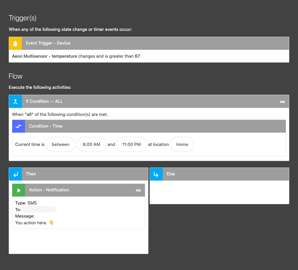

You’ll want to think of your rules based on their Triggers and then any further conditions, restrictions, or actions would be in your Flow.
So if the event that triggers the rule to run (and eventually checks your conditions), is the temperature changing above a certain value, then the trigger would be the temperature change. Then if you only wanted that to run during a certain time period, the first block in your rule would be an IF Condition with the time restriction.
You can also use time as a Trigger when that makes sense, but keep in mind that triggers are an event. Which means you could trigger at a specific time. For a range of time, as alluded to above, if you wanted to restrict something to happen during a particular time window, you would use your actual event as the trigger and use the time range as a condition.

Thank you so much @joshua_lyon for the explanation! I was very silly and didn’t realize that I could change between “before,” “after,” and “between” in the time condition! I had written my rule exactly as yours, but didn’t that it was that easy to change the time conditions! I’m gonna give that a try tomorrow morning and see what happens!

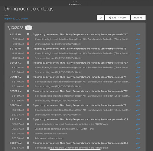

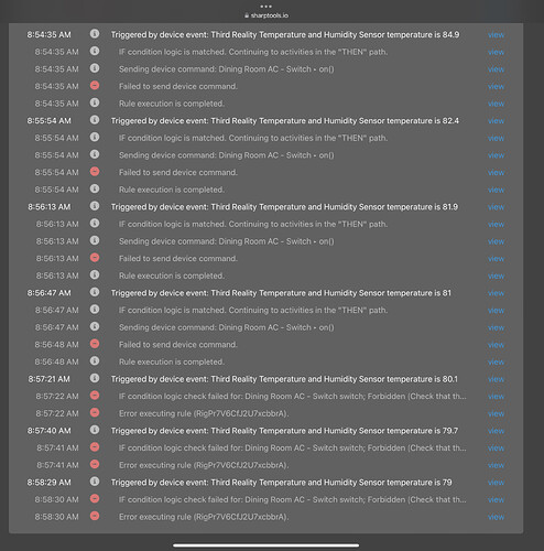

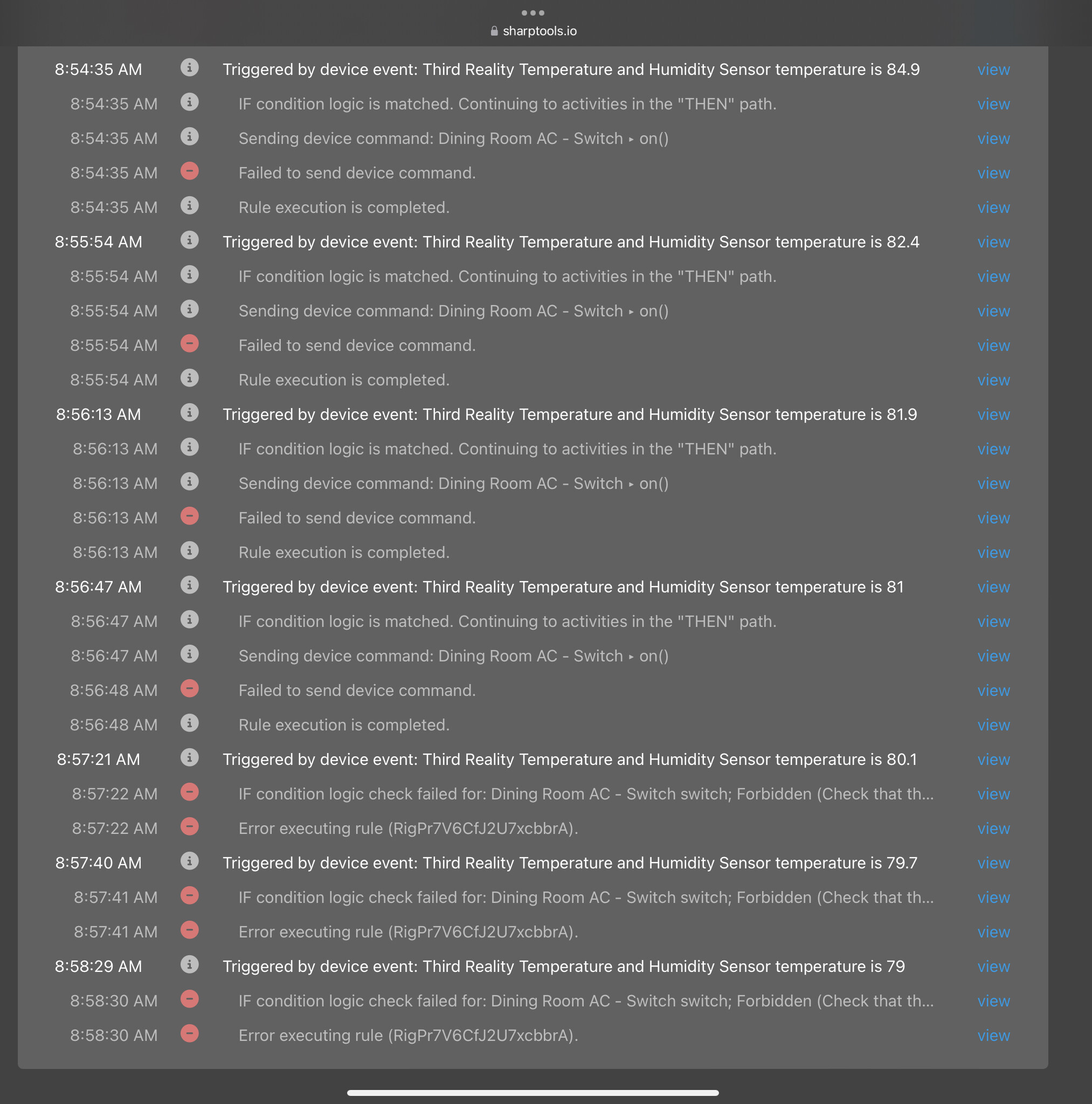

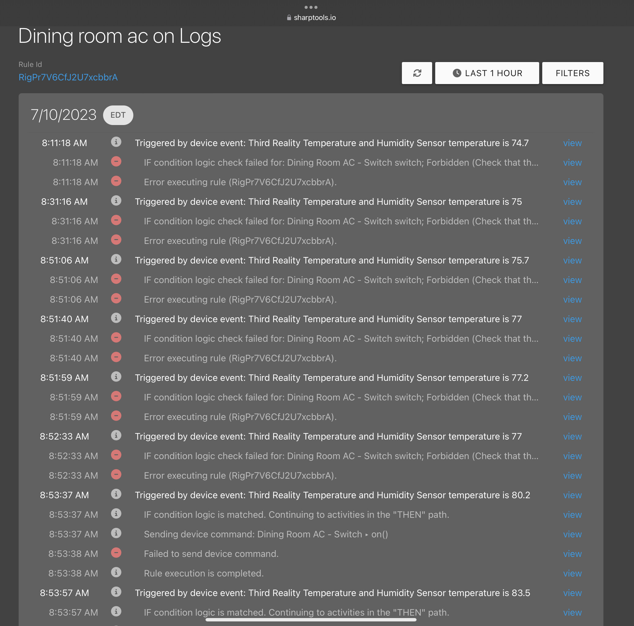

Man! This is the most difficult “simple” routine that I have ever written! So, now I’m having an issue with the rule running in Sharptools! I’m getting an error from the switch saying “IF condition logic check failed for: Dining Room AC - Switch contact; Forbidden (Check that the device still exists in the source platform),” and an error saying “Error executing rule (RigPr7V6CfJ2U7xcbbrA).” Does this have something to do with this being a Alexa virtual switch which has a contact and switch component.
I removed the switch from the IF section; however, I then ended up with a “ Failed to send device command.”
Any idea what’s going on?
I’m starting to think that this routine is going to defeat me!
The bolded message above is usually the most common cause of the error. If you’ve deleted / recreated / reonboarded devices, you’ll want to make sure you’ve synced over any changes to your SharpTools account by proceeding through the authorization process from your SharpTools User Page → Manage Connections.
I suspect that the device was reonboarded and it has a new device ID, so when you created the rule, the conditions and actions were pointing to the old device ID which is why you are getting those errors. Once you perform a fresh authorization / device sync, I would remove the device from the condition and action and reselect the ‘new’ device.

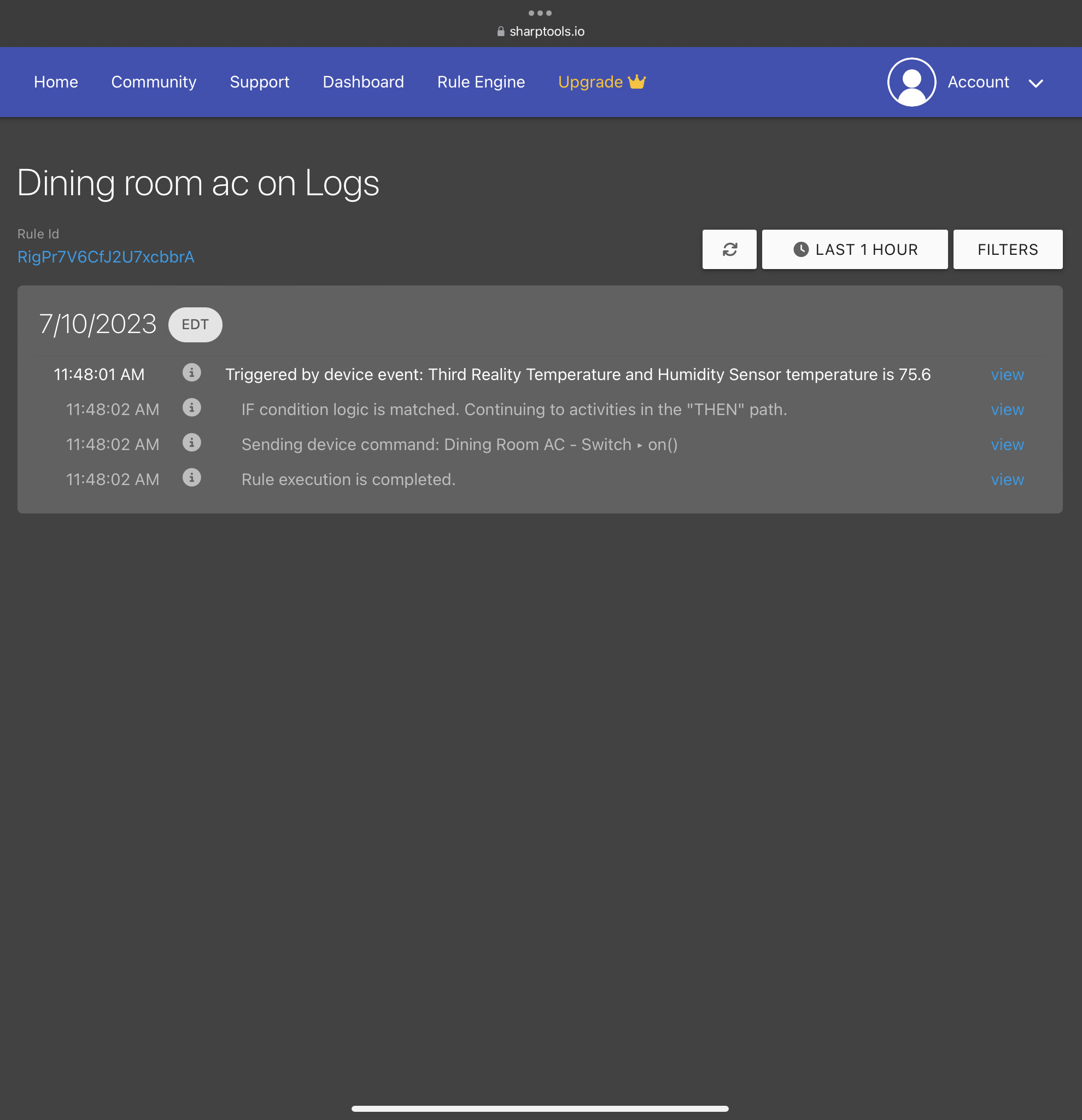

Success!
Thank you!!! That was it exactly! The rules now run as expected! Don’t feel like such a failure anymore! The cloud executions are working beautifully! This seems like it might be the way to go as it’s very stable and doesn’t require a ton of virtual switches or additional routines to complete
