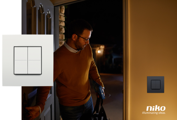

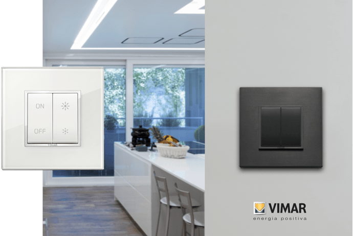

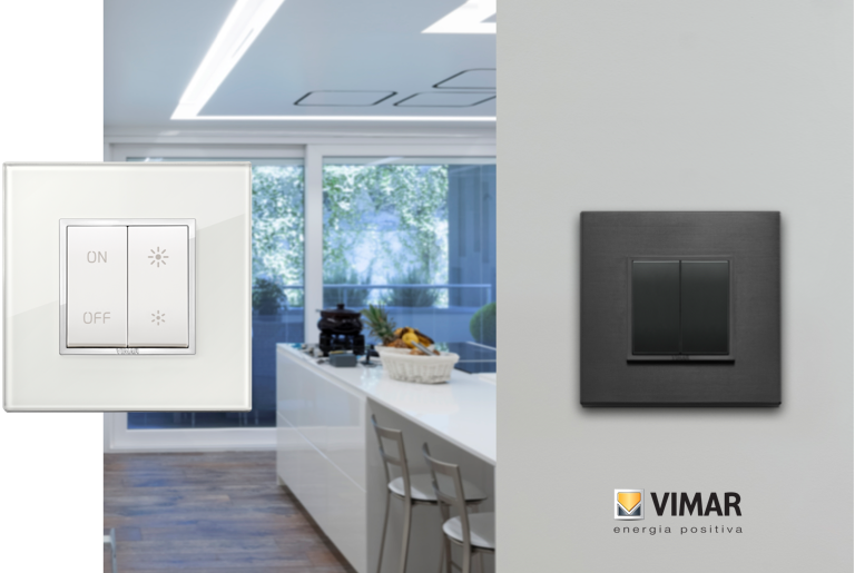

With regard to smart switches and smart bulbs, It doesn’t have to be one or the other, but you should not use any wall switch, smart or dumb, which directly cuts the power to the smart bulbs. The radio inside the smart bulbs can get damaged if that power cut occurs too often. (Two or three times a year because of power outages it’s not a problem, but every day as the regular means of control is.)
There is a solution, which is to get a switch which does not directly control the power but instead sentdo a message to the hub which then sent a message to the bulb. While leaving the bulb on power all the time.
Sometimes these switches are battery powered, sometimes they are Mains powered, sometimes they are “battery free“ which is a very fancy technology that captures the kinetic energy of the switch push to operate the radio.

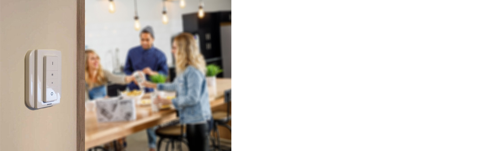

There are some very nice switches of this last type specifically made to operate with a hue bridge. They are called “friends of Hue“ because they are made by other companies, including some quite well-known lighting companies.
In Europe there are four or five companies making these in different styles and Colours, and they look quite nice. Busch-Jaeger, Gira and Senic, Niko, and Vimar are among the companies participating in this program in Europe.

There are other options as well, including battery powered switches from multiple companies. The Aeotec Wallmote is available in both the US and Europe and is quite popular.
Remotec also makes a multi button device available in both the US and Europe which people like if they want to have multiple different scenes. Each button supports press, long press, and double tap so you end up with 24 possible functions from an eight button device. So in your case, you could have one button that turns the ceiling lights on and off together, another button for just the left light, A third button for just the right ceiling light, the fourth button for one of the sets of table lamps, etc. it’s up to you, but it’s a nice option to have.
