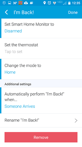

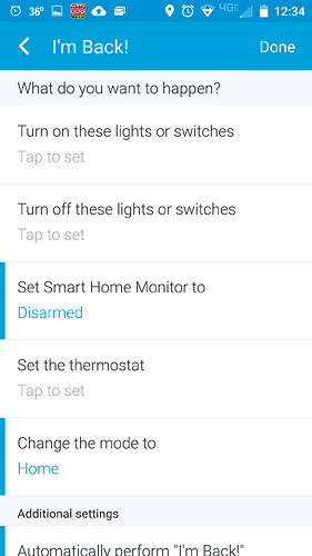

Depends on exactly what are you using. Are you using a routine? If so, can you post the screenshots for what you have set up? Smartthings is very powerful, but not always very intuitive and small details can make a big difference.

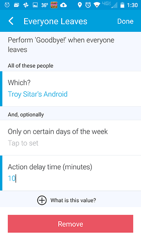

What do you have selected under Everyone Leaves or Someone Arrives?
Are these Phones?
If so, are they logged in on the app?
If one of the “Everyone Leaves” phones have logged out of the ST App then according to ST they are still home if that’s where they logged out…
At least this happened to me. Under Family, goto history and see when the last log updated.
Also if you have yourself signed into the SmartThings app on more than one device, such as on a tablet and on the phone, and you leave the tablet at home you will continue to show as at home.

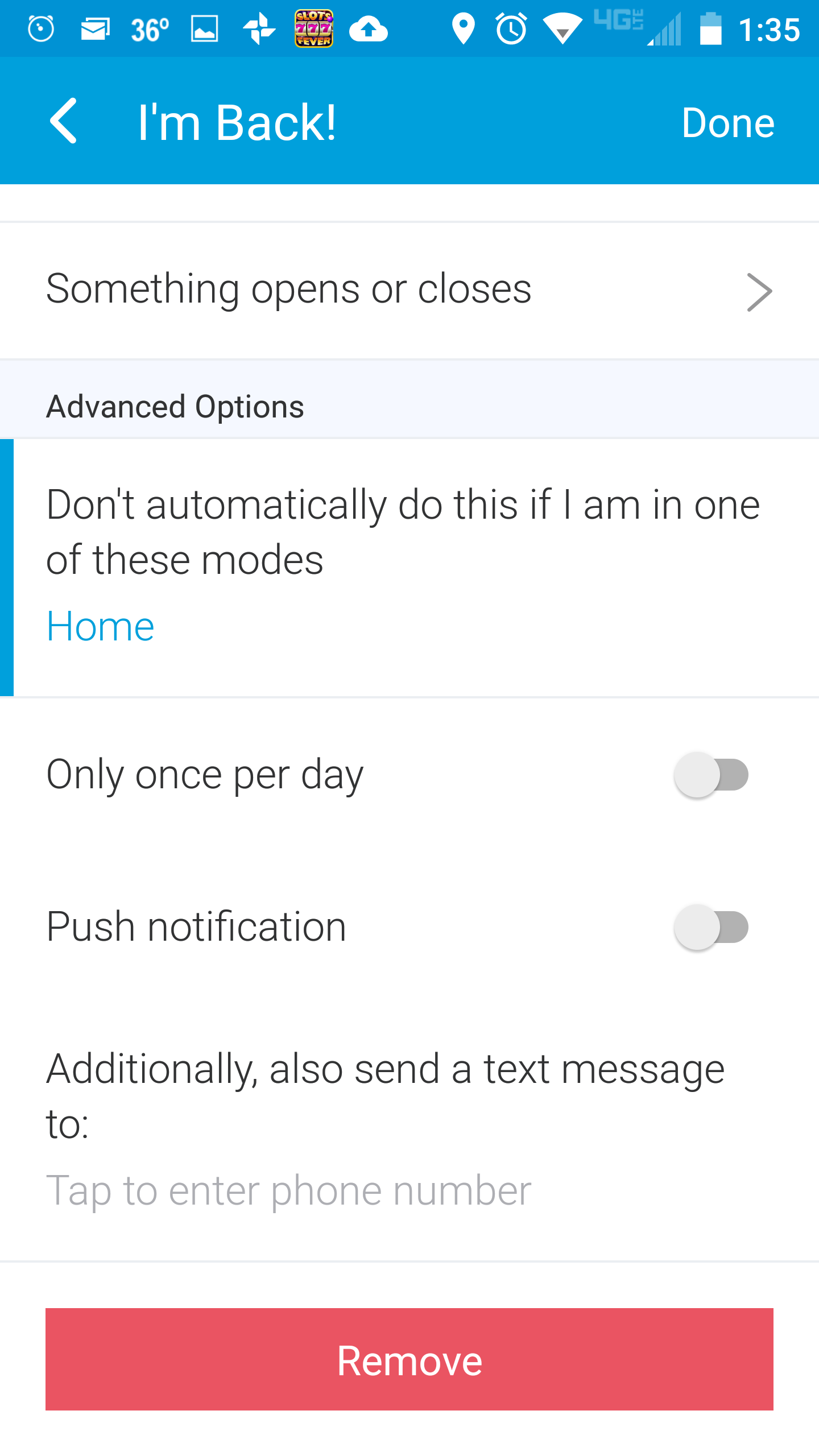

Finally, you only gave us screenshots a part of the routine, we need to see the whole thing. In particular, you’re missing this page, Advanced options, which should be below the “perform automatically” setting.

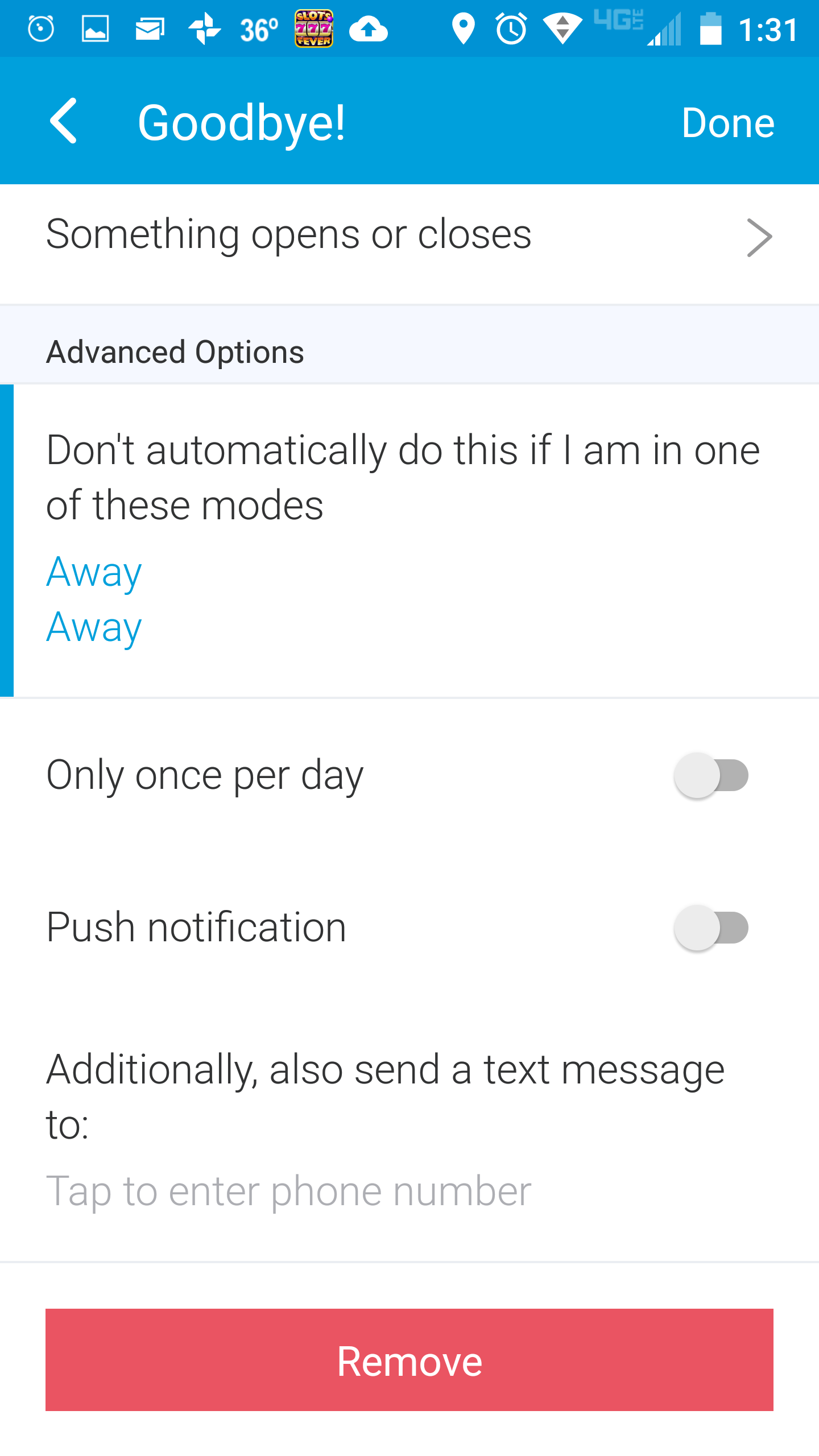

Also, try taking off the “don’t automatically perform this if I am in away mode” I think sometimes there’s a timing issue where it shifts to weigh mode before the arm get set and that confuses everything.
