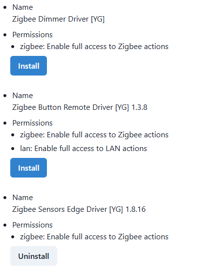

The model MCCGQ01LM and model MCCGQ11LM Aqara Door & Window contact sensors work with the Yakov’s edge driver. The driver can be sourced from Yakov’s Edge Drivers Channel Invitation.
  • After signing in to your Samsung Account, accept Yakov’s channel invitation.
  • Next click the “Available Drivers” button.
  • Find and download the "Zigbee Sensors Edge Driver [YG] 1.8.16 ” edge driver to your ST Hub.
  • If you need to update the driver, tap on your device to access the device settings screen.
  • Tap the three dots in the upper right.
  • Select “Driver” from the drop-down list.
  • tap on “Select different driver” and then find and tap on the "Zigbee Sensors Edge Driver [YG] 1.8.16” to install the driver.
Please note that the driver requires several minutes to update the device properties when changed from different driver. After a couple of minutes you should close and reopen the device settings screen to view the updated sensor properties.

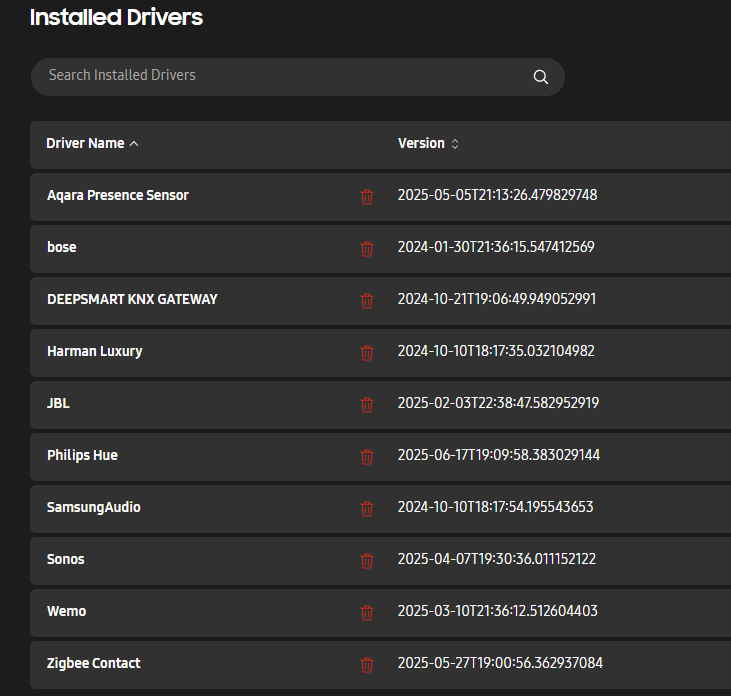

I did install that driver. Does the hub need rebooted or anything?
Did you go into the device settings and update the driver?

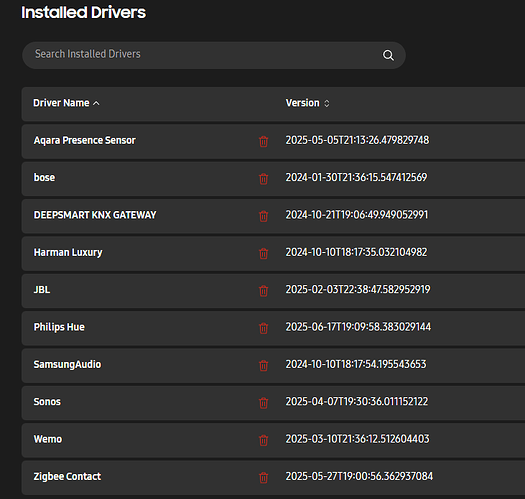

I was on this page and installed. Guess i’m missing something?
Or maybe here?
As stated above, if the sensor is not paired, you have to pair it to the hub before you can switch the driver. Move the sensor 1 or 2 inches from your Smartthings Hub. Hold in the small reset button it for 5 seconds. Sensor will blink blue light 3 times. Then after those 3 light blinks press button once every minute until it pairs. Once it pairs, click on the device, and while in the setting screen, tap on the three dots in the upper right, tap on drivers to determine which driver is installed. If you wanna switch drivers, you can tap on select a different driver, then select the driver you want to replace the current driver with.

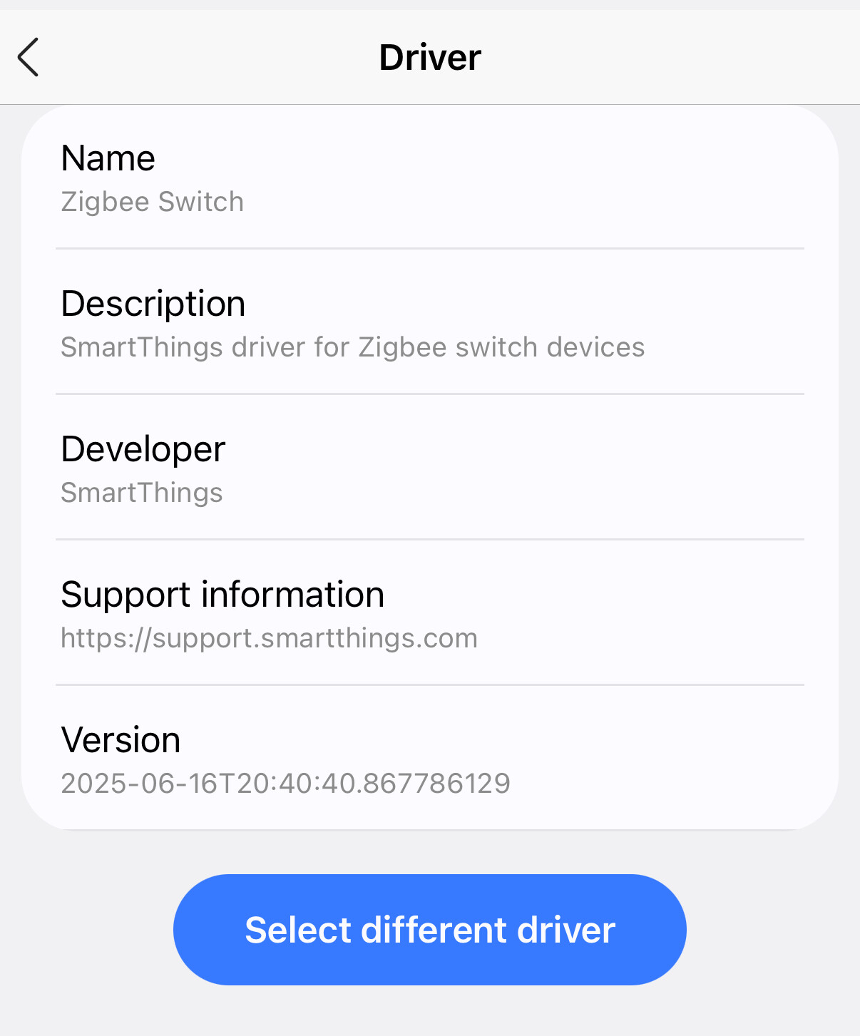

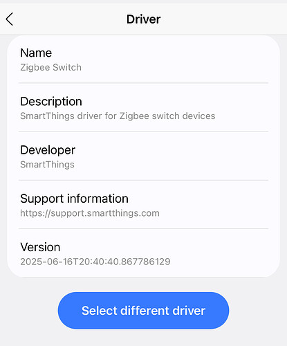

its seeing it as a switch so is this where i would select the different driver or is there something else to note this is a sensor and not a switch? Thanks for all the help!
Aqara devices have a mind of their own. I have a contact sensor that disconnected and I tried so many times to reconnect it and eventually game up. After seeing this thread I decided to give it another try, and low and behold it connected first time :man_shrugging:. Baffling
