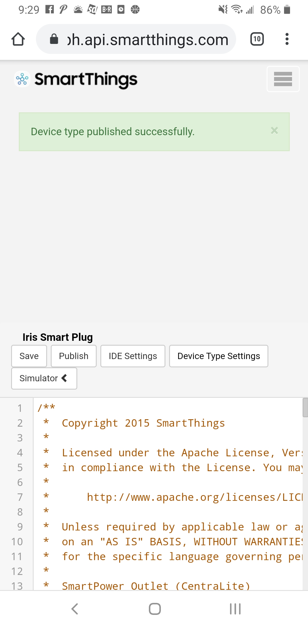

Are you using a custom device handler for these devices? If yes, login to IDE and open the device handler and publish for me again. Then exclude and try to pair the devices again. There is a known issue where the device handler can become stale and prevent the devices from pairing.
I assume you mean to just press publish for me and not delete the code and re-enter it.
That is correct. Just click on Save and Publish for Me
Thanks that worked for the zigbee side but not the Zwave repeater.
