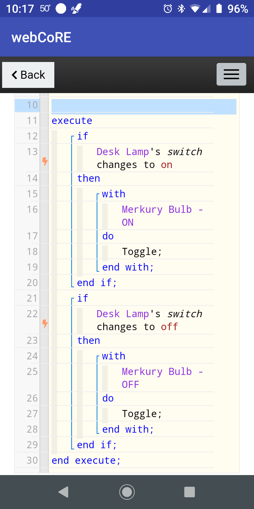

I create a virtual switch in the IDE and then create the following piston in WebCore

If you look at the example I posted earlier today you will see I have 2 separate “if” automations in that piston. No “elses” were used.

If I add an If block and then add a condition I get the if, then, else by default. I have not found a way to get rid of the else. And I have not been able to find a way to delete it without deleting the entire condition.

Kevin, look for the Add a new statement line underneath your first IF while in edit mode. Click on it and add your second IF.
Thanks for the suggestion. It still leaves the else statement in the piston.
I think I have it working even with the else. It has to be a legacy feature. I just started using WebCoRE and all my pistons have the else but I can see old pistons without the else but if I create a piston from them the else is added to my piston.
It would still be good to have a txt editor for the piston. Using the UI is good to get started but doesn’t allow fine tuning.
That’s weird. The else is typically there in the edit screen when you have complex Ifs selected, but it would disappear when reviewing the saved piston.
