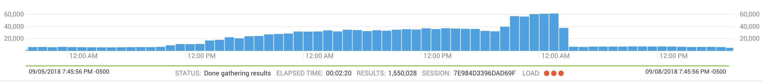

Are you still seeing GroovyCastException? We patched an issue introduced on Thursday that affected community developed SmartApps and DeviceTypeHandlers late last night. This is what I’m seeing
