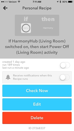

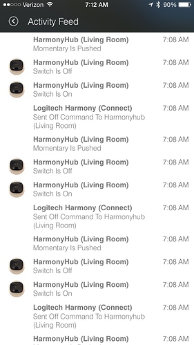

Is anyone else still having problems with IFTTT? My tv continues to power down randomly to the point my wife told me to turn it off LOL not a good first impression :(. As you can see, it’s run 189 times in 24 hours!!! I am also showing activity log from my momentary button.

I am wondering why your log shows all the activity from the harmony connect smart app. Mine shows no activity between the harmony connect app and the virtual button. The only activity is between the echo smartapp and the virtual button.
Or are you in the harmony beta? Did somehow you set that up to send something?

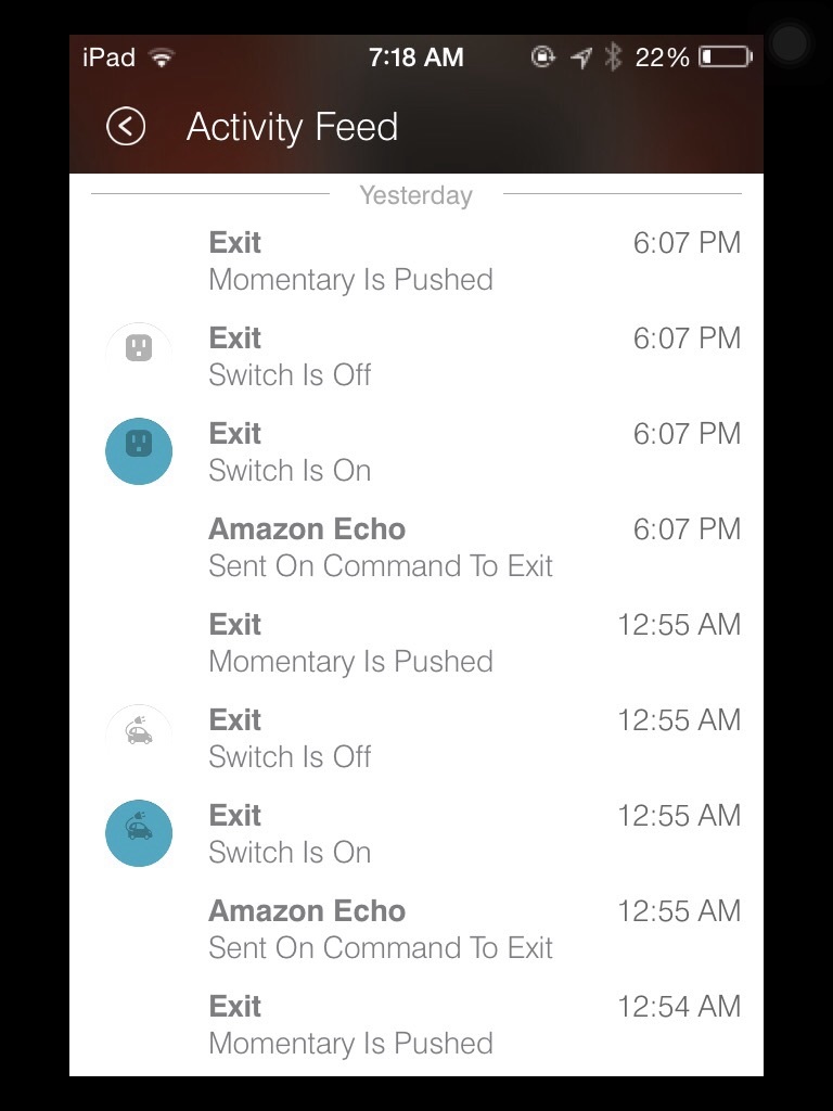

Here is my log, you can see the difference:
It looks like maybe you have a loop where the Harmony power off activity turned off the switch which, because it is a momentary, does its on/off trick and that triggers that same recipe? But again I don’t know why the harmony connect smartapp is involved at all.
Also notice that in my protocol, I use IFTTT to send an “end activity” for the power off. You are sending a “start activity.”
My protocol has one IFTTT recipe for each regular Harmony activity like Watch TV. Those each send a “start activity” when their momentary button is pushed.
Then I have one extra harmony activity, with one extra IFTTT recipe for it. That’s the power off. Unlike all the others, that IFTTT recipe sends an “end activity,” not a “start activity.” (See post #23 above.)
So a couple of differences between the way I do it in the way you’re doing it. I’m not sure what the exact problem is.
But I definitely think something in your steps is looping that momentary switch
Thanks @JDRoberts. I switched my IFTTT recipe to End Activity from Start Activity. I am not home to look at my Harmony Activity, but I believe it’s set to Power Off all Entertainment devices. Not sure if I need to do anything in that activity to make sure the End Activity works right?
