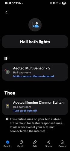

I recently installed an Aeotec dimmer and multi sensor 7.
Simple routine:
When the sensor the detects motion, dimmer turns on.
This works fine
Simple routine with time delay:
When lotion is detected dimmer turns on
Delay one minute
Turn off dimmer
For some reason this is not working for me.
It appears any delay that is put in the routine will not allow the routine to activate..
If I put a delay in the routine and hit test routine the light will not come on.
Any help would be much appreciated.

Also btw, routine test skips any and all delays. Read the fine print!

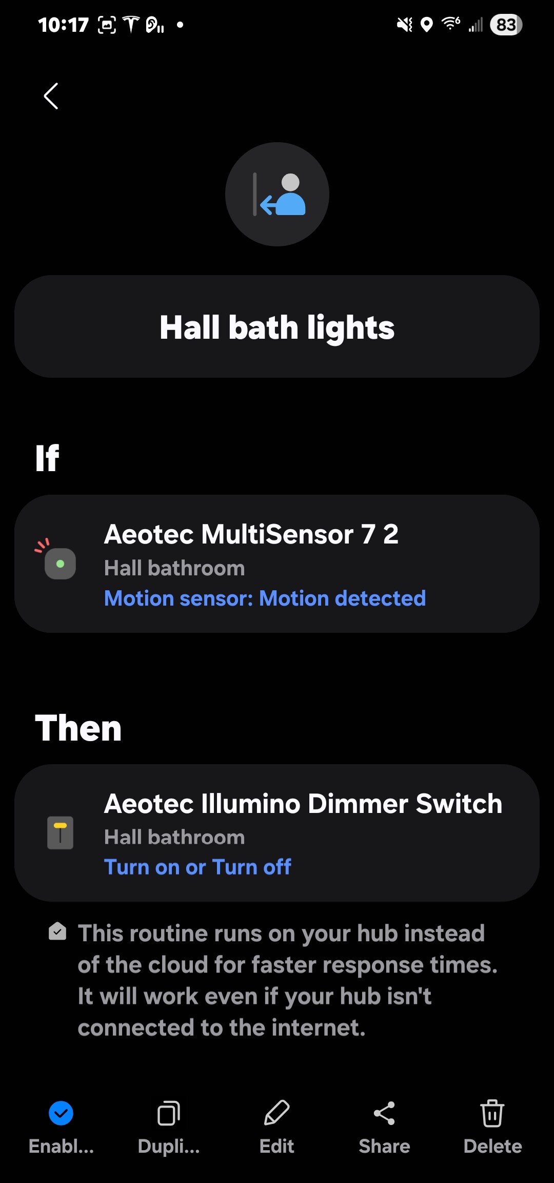

In the second screenshot I posted, should that Routine work? I now understand that, if I don’t want the light to shut off while someone is in the bathroom, however I am testing to see if the motion sensor will trigger the switch and the shut if off.
I am using the illumino dimmer switch from Aeotech. I have been have lots of issues with it not working. Tech support has been slow.
I will try this and see if that will work, but so far it won’t shut off after I put a delay in the routine.
You should make sure that it works correctly before you start setting up and testing your routines.
The routine in your second screenshot looks good and if it doesn’t work, it might be an issue with your device.
Not sure if I did this correctly.
These look correct to me. Mine are the same, and they work fine.
